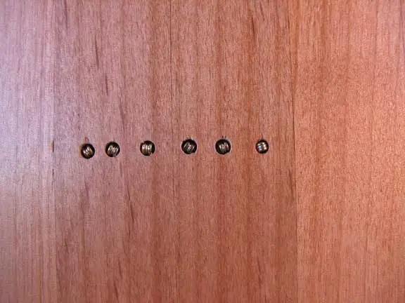

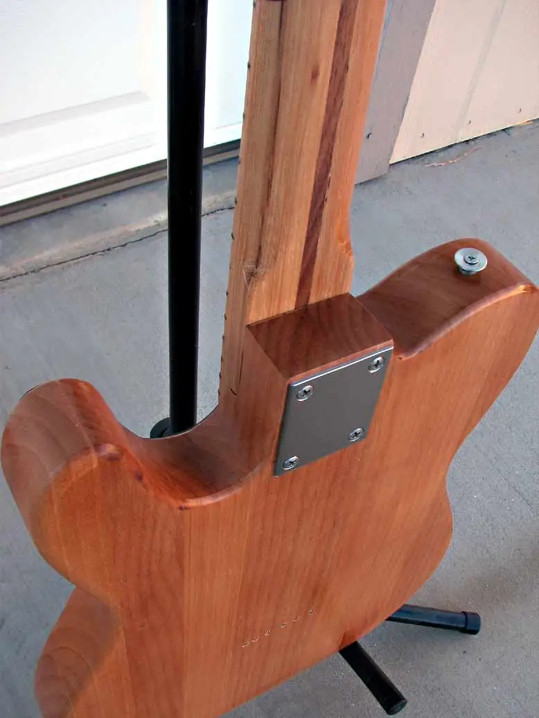

Strung up. I couldn't get the body far enough into my bench drill press, so I had to drill some of the holes with a hand drill, and my angle was a little off - hence the spacing a little off.

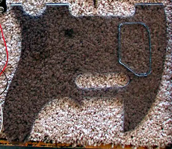

Pick guard - copier translucent plastic. Didn't drill the holes yet. The cutout is the battery access cover. It will stick to the battery by a copier door magnet glued to it.

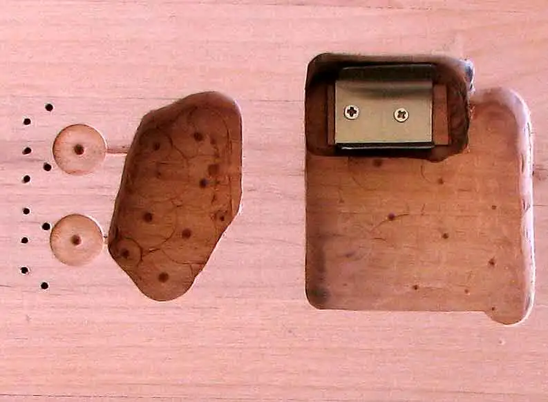

The clip to hold the battery in place - more copier sheet metal.

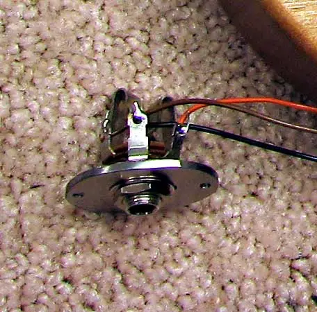

Jack plate - same steel as bridge, neck plate and control plate.

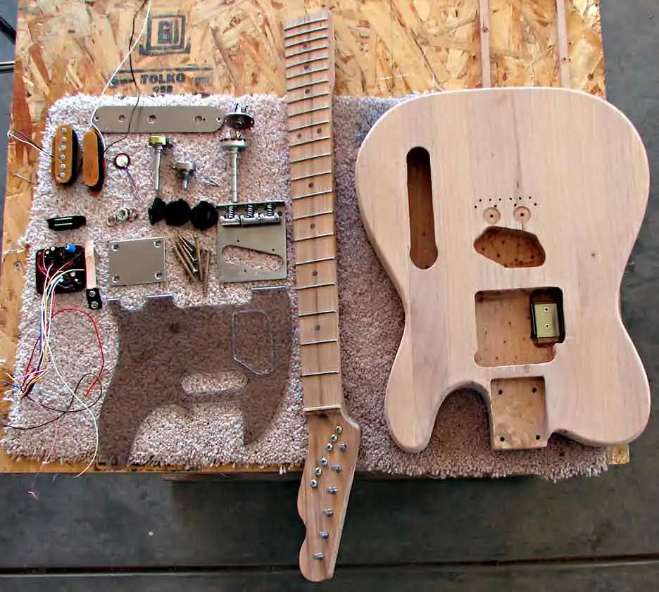

Group picture - most of the parts prior to finishing and assembly.

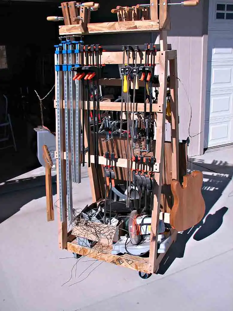

I sprayed polyurethane from a left over rattlecan for the finish - about 3 coats on the body and 5 on the neck. They're hanging to dry from my clamp rack. You can't have too many clamps (or guitars or mics.)
Yes, I was too lazy to take the tuners out before finishing. :)

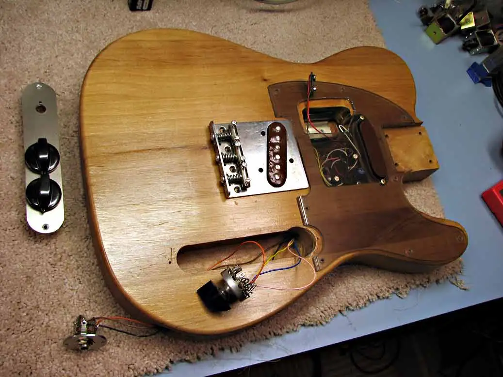

Anyway, time to wrap this up. I don't have many pics of the assembly process - it's pretty straightforward screwing things together and wiring. Here I was just trying it out, bypassing the volume and tone controls.

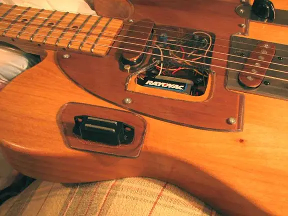

The battery cover clamps on to the battery with a magnet (from a copier door, of course.)

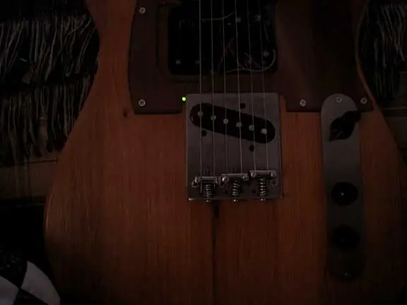

The electronics switch on when the cable plug is inserted into the jack. I thought I'd add a status indicator LED. I've since moved the location centrally by the bridge.

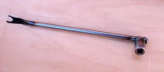

I made a tuning wrench from a copier rod. One end I pounded flat and made an open end wrench for the fine tuners, and on the other I welded a 1/4" drive socket for the tuning pins.

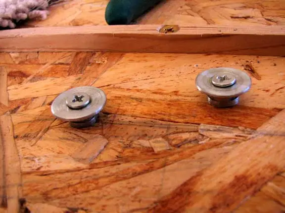

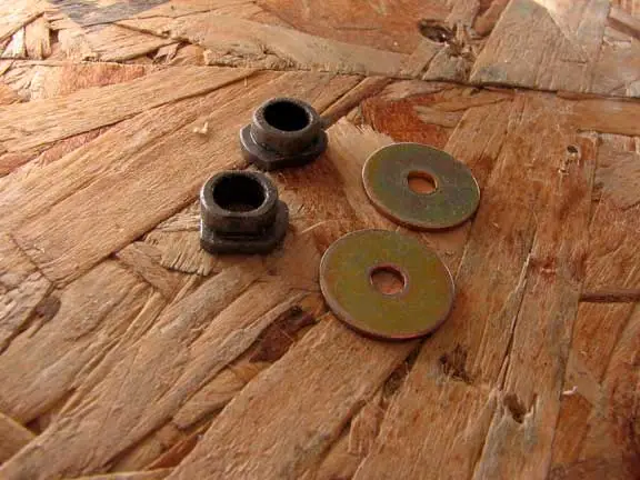

Strap buttons from copier bushings and washers. Raw materials.

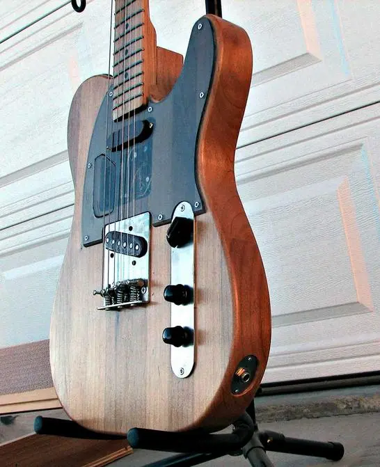

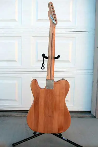

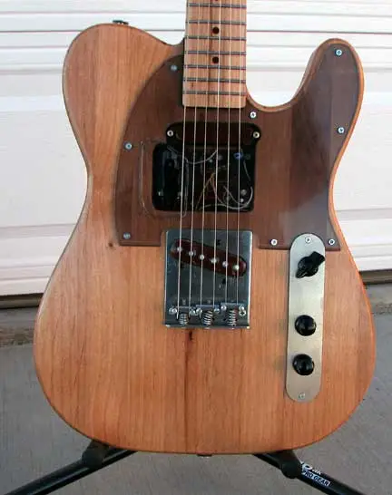

Pics of the finished guitar. Front.
