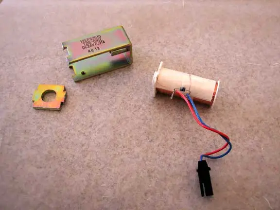

On to winding the pups. The copier had a number of solenoids. The resistances were in the 50 to 80 ohm range, and the wire gauge probably in the mid 30's, so obviously wouldn't match the input impedance of a guitar amp. I'd need active electronics to match impedances. More on that later.
Here is a solenoid from the copier.

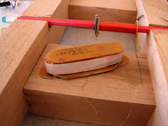

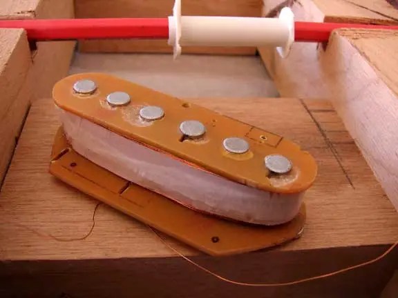

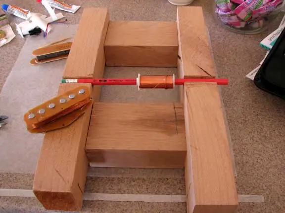

I made a simple spool holding jig (the fret slotting jig, upside down :)), and wound the pickups by hand. One took about 900 turns, and the other 600.

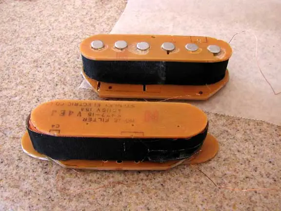

The bridge pickup.
The neck pickup.
Both pickups.

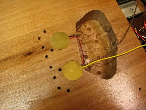

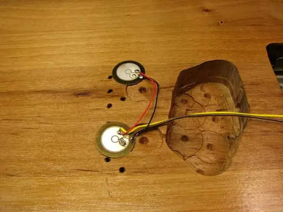

I had some piezo discs, so I mounted them under the bridge.
Just another tonal option. Very bright and gritty.

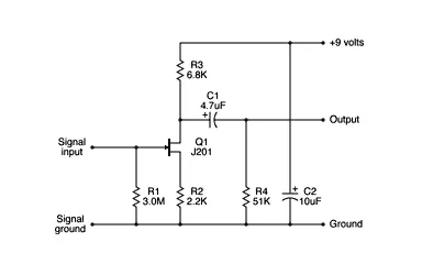

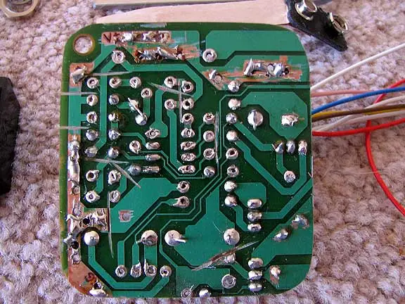

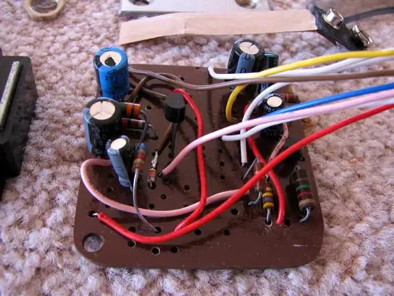

The copier had multiple circuit boards. I scarfed parts off them (got everything but the FET which I took from my parts bins), and cut a board down, cut traces to make into sort of a prototype board, and soldered in the components and wiring for the three preamps.
Unfortunately I didn't clean off the copper very well, so the soldering is pretty gross. The battery clip is the clip in an old 9v battery.
Top of board.

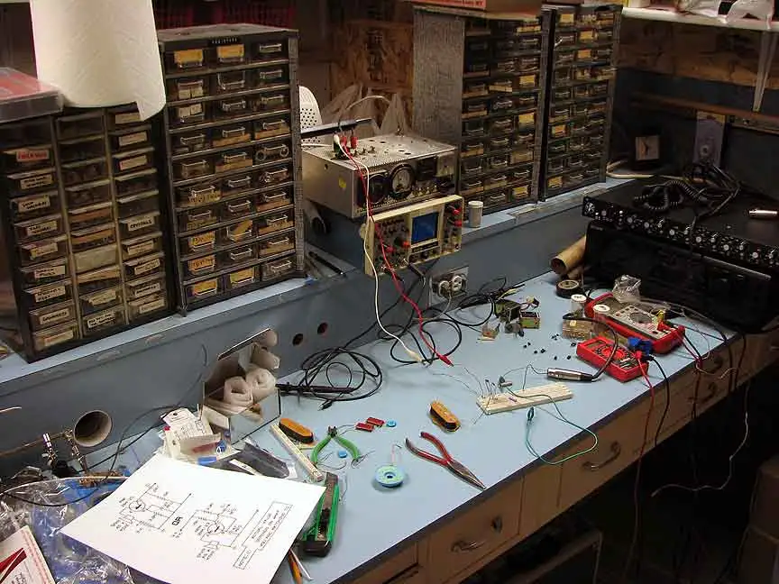

I did have to fiddle with the circuits and tweak them a bit before I made the board. :D

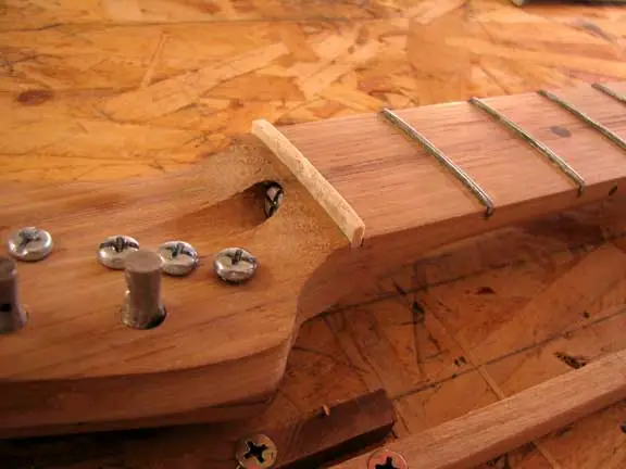

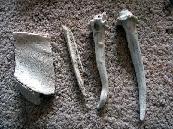

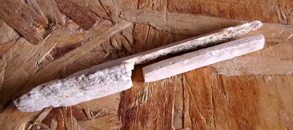

The nut - available materials. Old bones and antlers.
I used this piece. Although it looks trabecular, it was solid inside.

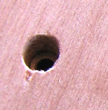

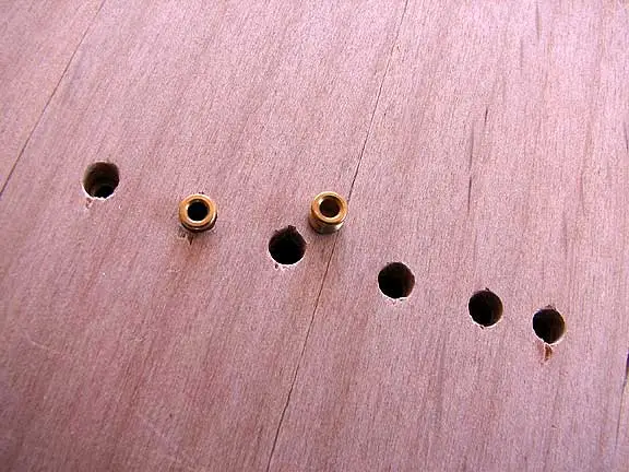

For string ferrules I used the ball ends off of old strings.
