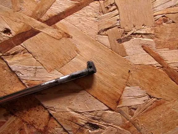

I built up a weld on one end and shaped it to a hook, so it wouldn't rotate or move longitudinally.

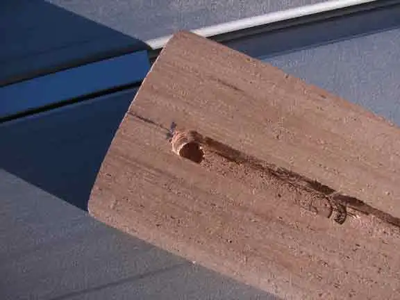

This would fit into a recess in the heel end of the slot.

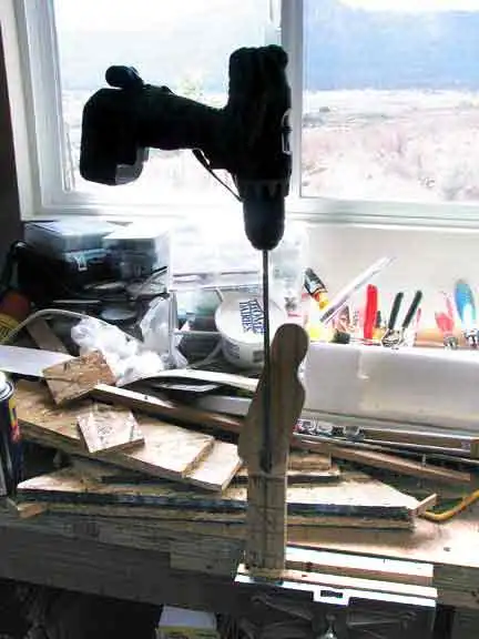

I threaded the other end, and drilled through from the headstock to the truss rod slot. (I had to make a long drill bit from another roller shaft.)

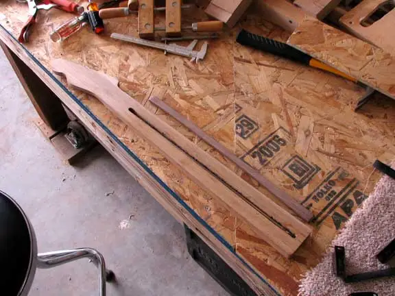

I installed the rod and made a plug from a scrap of walnut, which was glued in and cut/sanded down.

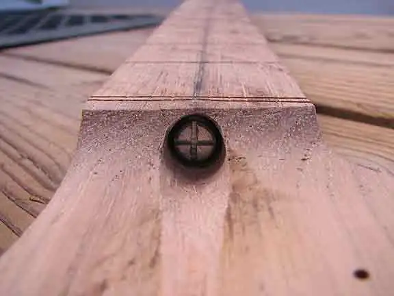

A nut made from a 3/8" roller shaft was threaded on the headstock end for truss rod adjustment.

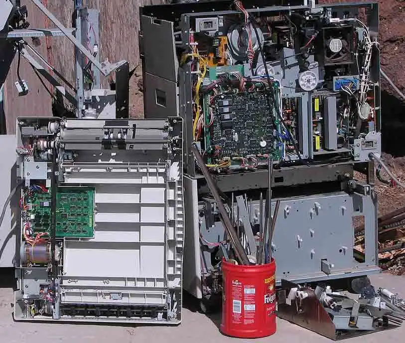

Here's a pic of the copier, after a hugely enjoyable day of tearing it down. (If there's anything I like better than building something, it's tearing something apart.) And this doesn't even show the two bins of sheet metal and plastic parts.

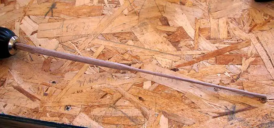

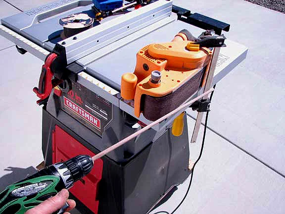

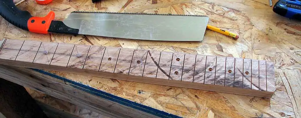

Next, the fretboard. I took a scrap of walnut left over from the truss rod plug, and turned a dowel using a hand drill and belt sander.
This was cut into sections, and these were glued into 1/4" holes.
The dowel was turned smaller for the side markers, then similarly fit into holes.

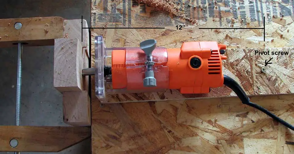

This is a jig making a 12" radiused sanding block to sand the fretboard. The router swings back and forth, and the block is raised a little with each pass to make a new cut. The block was about 10" long, and sandpaper was glued to the radiused portion with contact cement. (I don't have a pic of the finished block.)

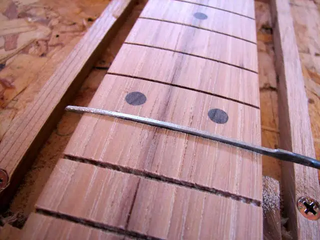

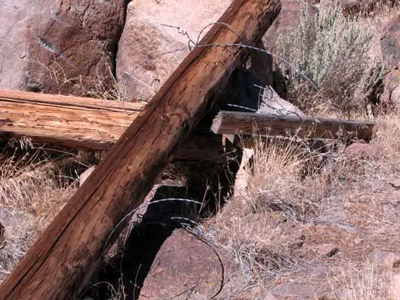

What to make frets out of? I was thinking of HO gauge model train track, but I couldn't find my boxes of train crap. But there was a bunch of fence wire out on the property.

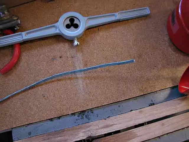

I beat it with a hammer on an anvil to flatten it.

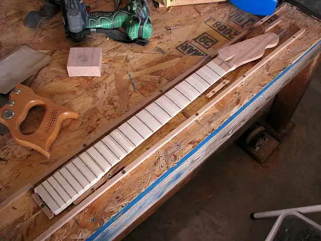

Meanwhile, the back of the neck was shaped with the belt sander, the fretboard radiused, and the fret slots recut to correct depth and width. Here is a piece of the fretwire cut down to measure the correct depth of the slots.
The neck taped off to avoid glue spillage.
