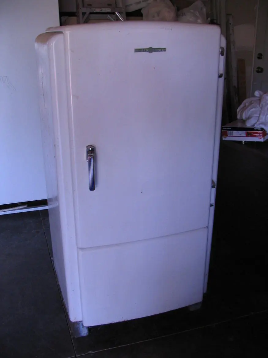

Old GE refrigerator from, like, 1938.
It just quit one day. It would only "hummmmm".

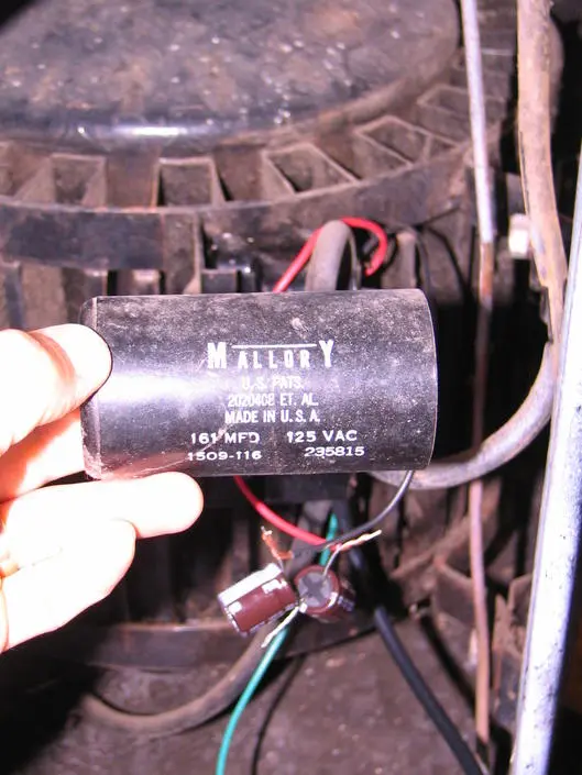

I wondered if it was an easy fix so I pulled it apart as well as I could to look at the back side of the compressor where all the wiring is. I figured it was either bad wiring, a bad relay or...hey...lookit that (I said) there's a cap in there...161uF/125V big can cap. OLD, but not original I believe. I thought "if that cap is bad maybe there's just not enough ooomph to kick over the compressor."
Well, its working now.
Guess all this electronics tinkering counts for something. My wife will be pleased as the apples and pears are about ready to drop and we haven't a place to preserve them while she dries them and/or cans them. She does now.
The wiring is pretty scary. I cleaned up what I could but ideally it should all be replaced. I didn't have a proper cap value-wise but I did have a couple 470uF/63V caps which I wired in series which I believe gives me about 235uF and 126V. Its just patched together at the moment to test but its working great. I'm surprised actually. MAN those old refrigerators chill down fast! I can't believe the exchange rate. The refrigerant is scary stuff: sulpher dioxide.

Thats a cool lookin fridge.It almost looks 'Analog' in a way.If that makes sense.
And yes,it is cool that you could apply your knowledge from fixing old audio gear to repairing something that is
needed around the house.

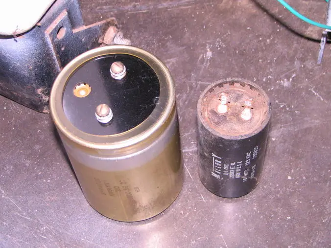

Lemme snap a pic of the cap, jp. Its still not as big as the filter cap off the 24V supply on my Ampex MM-1000. :)
Here it is. In the first pic you can see my new temporarily wired series cap array below the Mallory cap I pulled from the unit. I'm pretty sure it is a replacement because it was just held to the mounting bracket with baling wire. The compressor is the finned thing in the background. No belts. Its amazing how well this thing works after...what...nearly 3/4 of a century?
The second pic shows the cap next to the old filter cap off the Ampex supply.
Old stuff.

Yeah, which is why I'm pretty sure (in addition to the fact that it was strapped down by twisted baling wire), that it is not the original cap, but a replacement.
