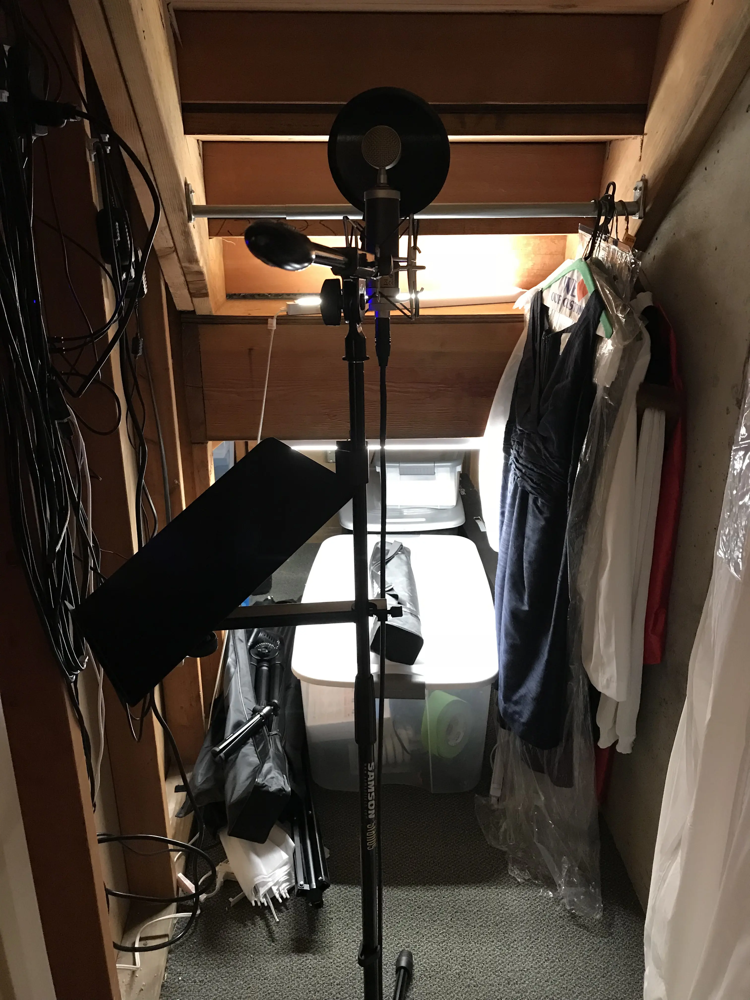

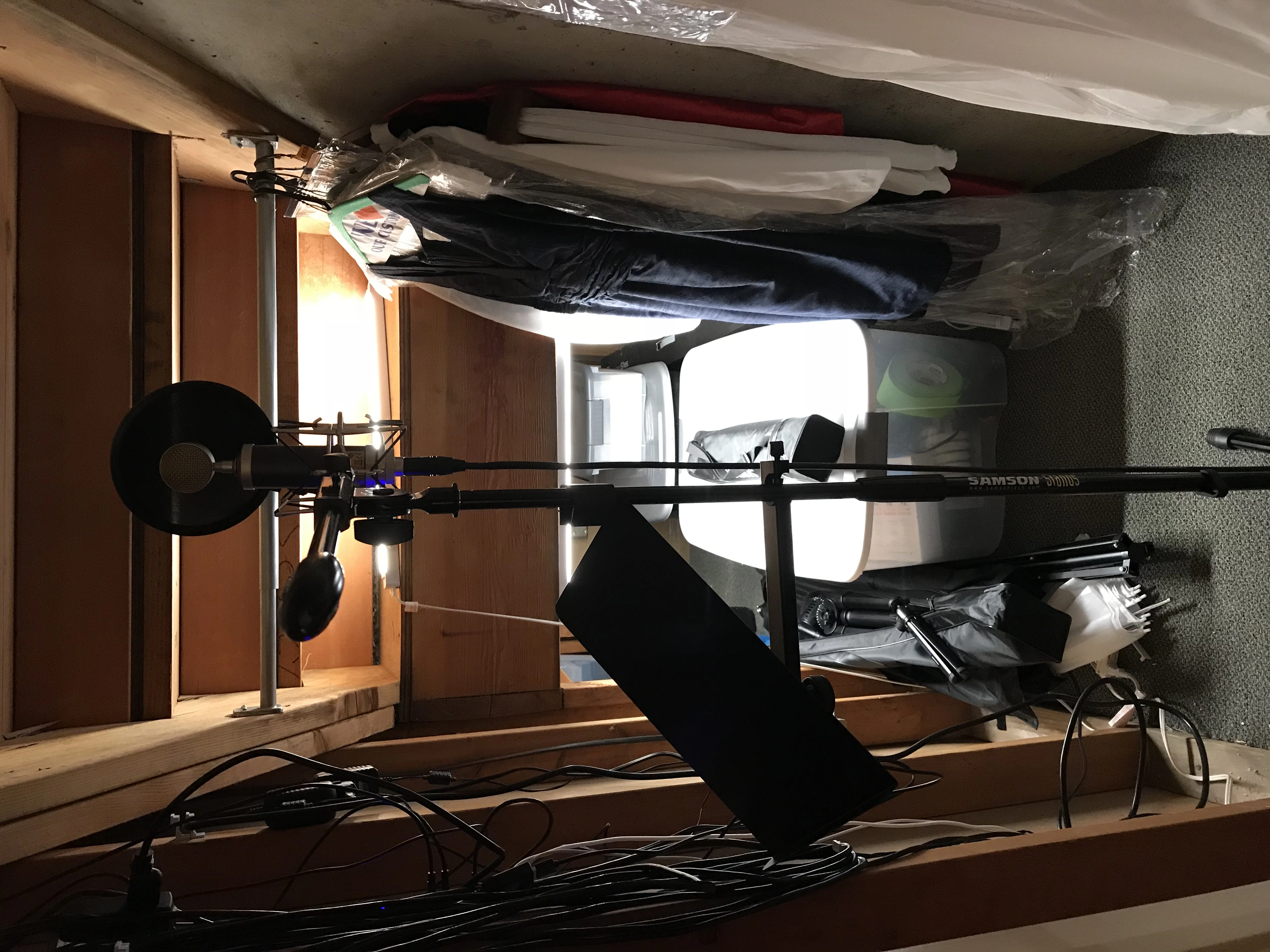

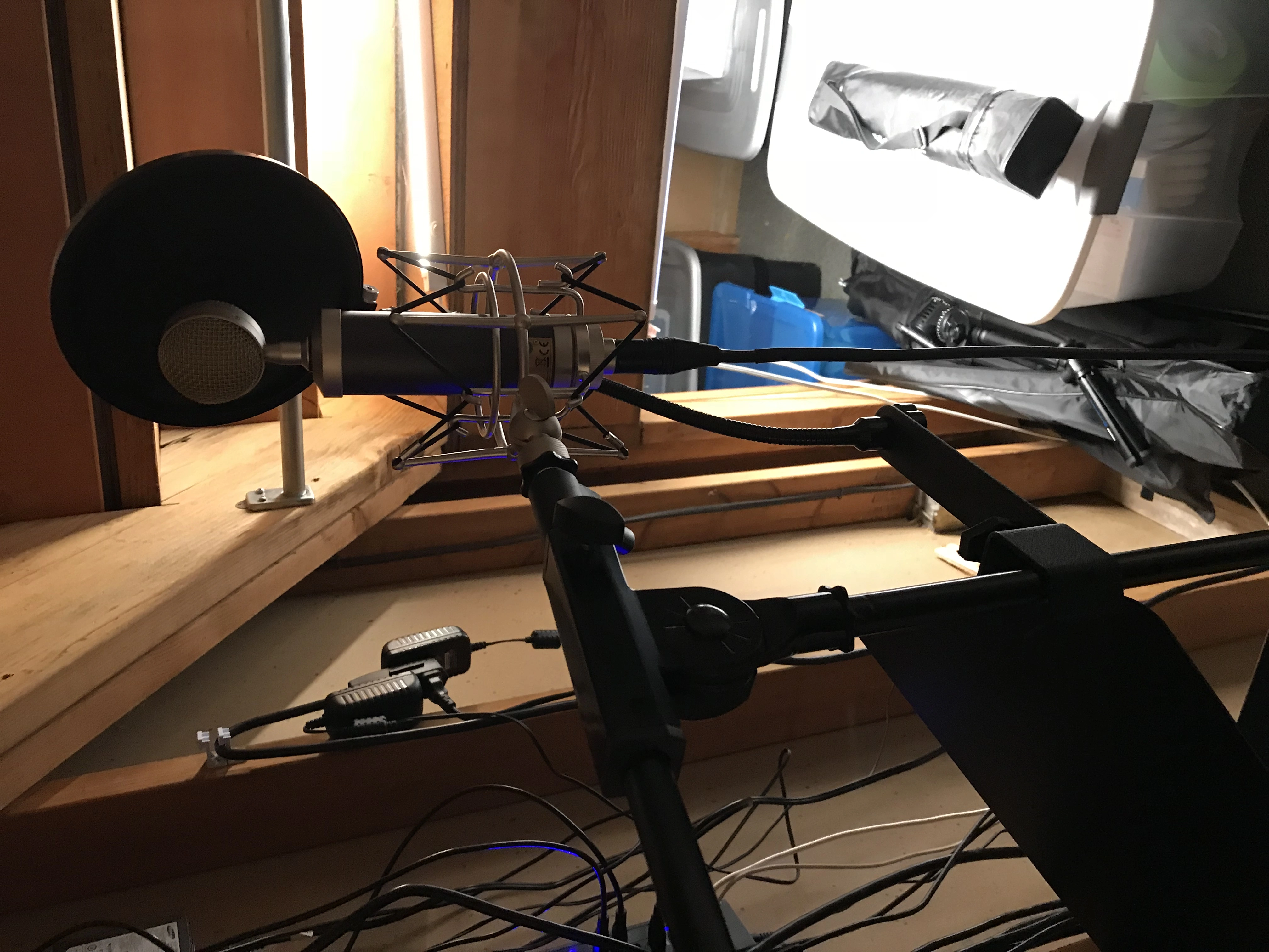

The photo is taken by the door to this crawl space/closet. No acoustic treatment aside from some egg crate material on the door. Any suggestions?
Yes! Lots! Egg crates do Jack, replace with underlay and carpet*. The space between the studs could be filled with GF or rockwool etc without impinging on the space. Hand an absorbent panel, big as you like, 6" deep filled with GF of similar in front of the window. Hang more heavy clothes in there.
*Out in a room, for things like acoustic guitar a hard floor can be useful. And, looks about a mtr wide? Other dims please.
I'm not sure that the idea of spending $3500 on technology that you will use in a closet is the wisest investment.
I'd recommend getting out of the closet and into the biggest room you have, record in there and see what the results are like. Then decide how to spend your money. And don't spend it on egg crates.

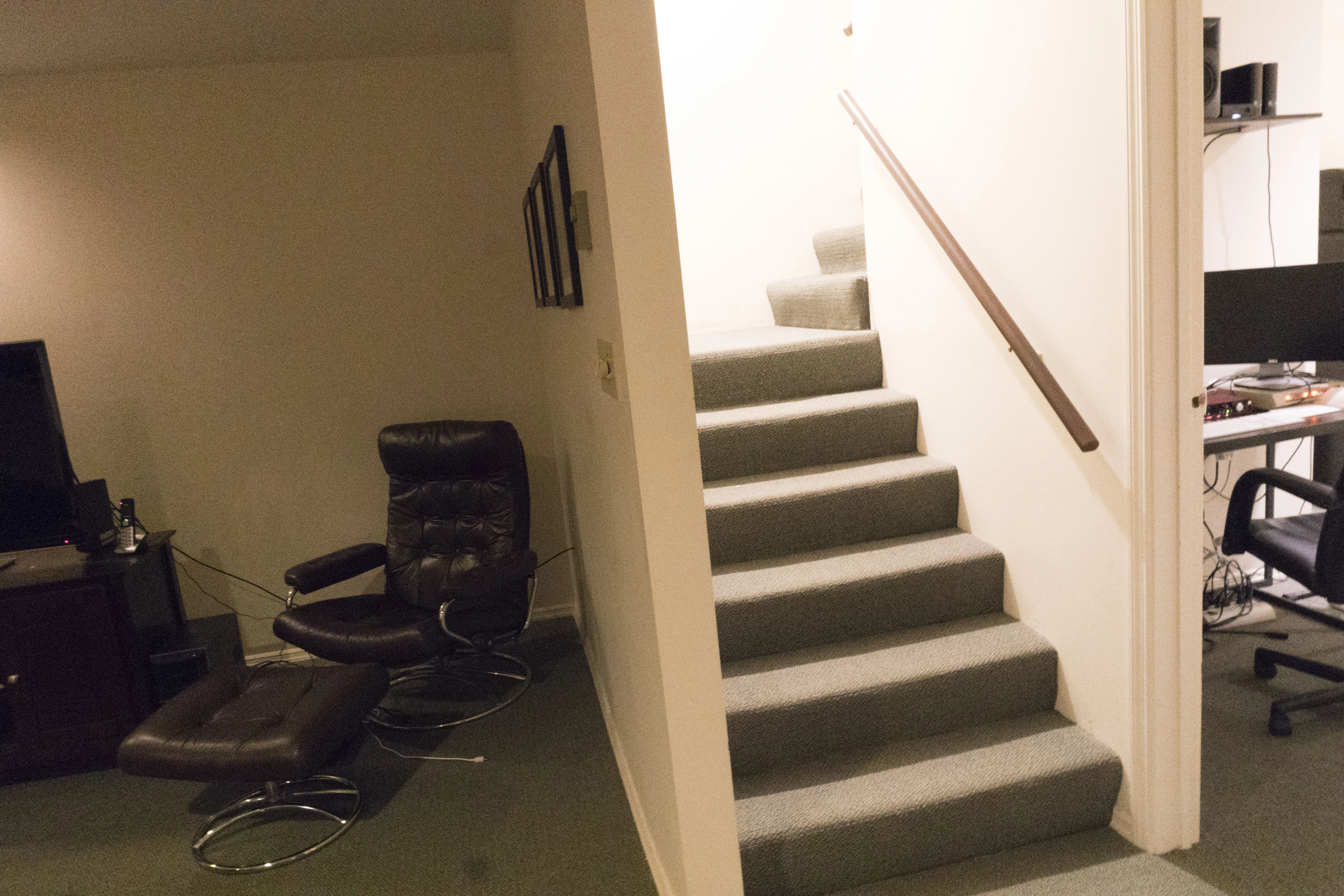

I will walk you through the setup but the file sizes of photos require me to send in multiple posts:
1. The room on right contains the recording equipment and closet. Note the stairs, (this will make sense in later post.)Stairs and Doorway And Chair.webp

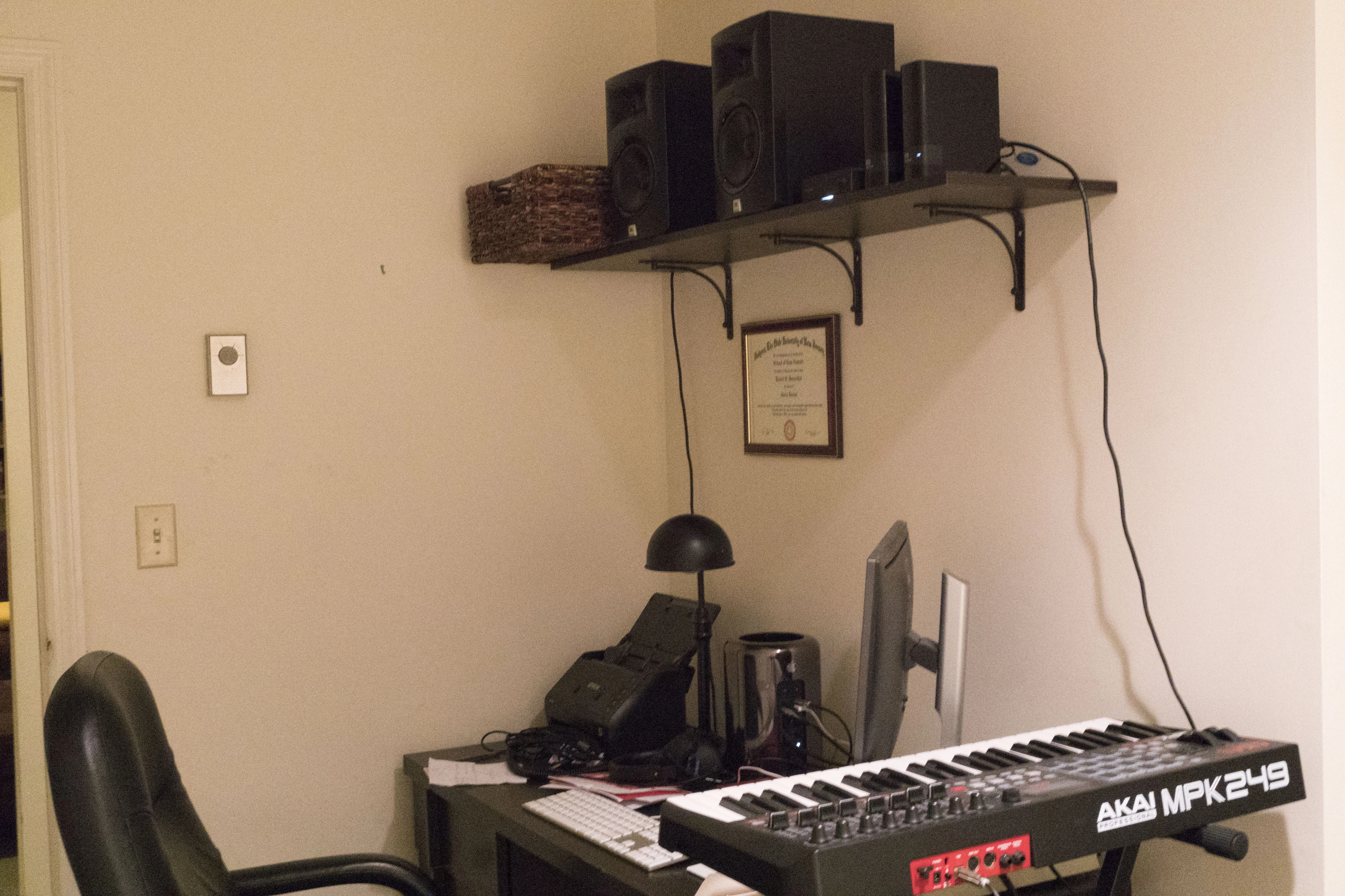

2. This is the setup. JBL LSR305s monitors. I mostly stick with my headphones which Sony MDRs. The shelf is noisy, especially with 7200 RPM hardrives so I am getting 3 Auray IP-M Isolation Pads. 1 for each monitor and one to sit the hard drives on.
