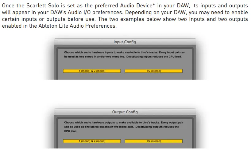

Whenever I set the recording device (Scarlett Solo) to Mono/Single Channel, the microphone stops working. Whenever its set to stereo, it will record in the left channel. But when it is set to mono, it does nothing at all. This is in Windows 10. Does anyone know whats wrong?
the audio device config for Input should be 1MONO/2Mono....not 1/2 stereo.
did you check that?

In Windows 10, the Solo is set to 1 channel, 24-bit, 48000 Hz, but does nothing; In Audacity, the settings are set such that:
Input: Focusrite USB Microphone
Channels: 1 Mono (Available choices are 1 Mono, 2 Stereo)
Output: Focusrite USB Speaker Output

When the microphone input is set to stereo in Windows settings and Audacity is set to record in stereo, audio will input through the left channel. When the microphone is set to mono in Windows settings, nothing works. This also means that using Windows 10's built in Voice Recorder app does nothing.
Setting up the input in Audacity should have nothing to do with Windows if you have the proper ASIO driver installed and selected.
