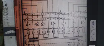

Please someone tell me what this schematic means. I understand the transistor symbol. What are all the dashed lines and 1,2,3 with circles?

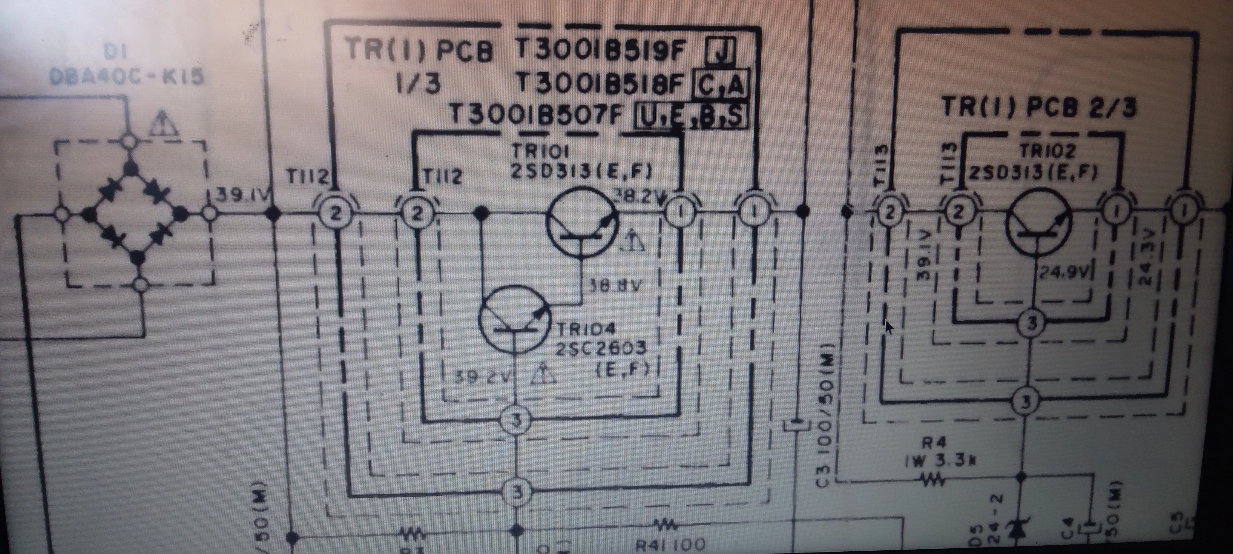

These are probably your primary secondary tertiary taps per transformer on the assembly

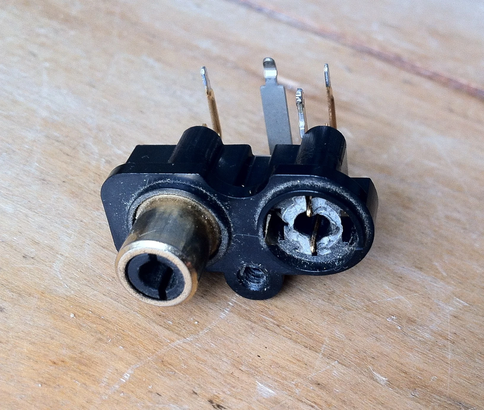

I'm looking for this 3 pin vertical RCA mount from the mains and monitor out section, please let me know if you have a spare for sale or generic part number, thanks
