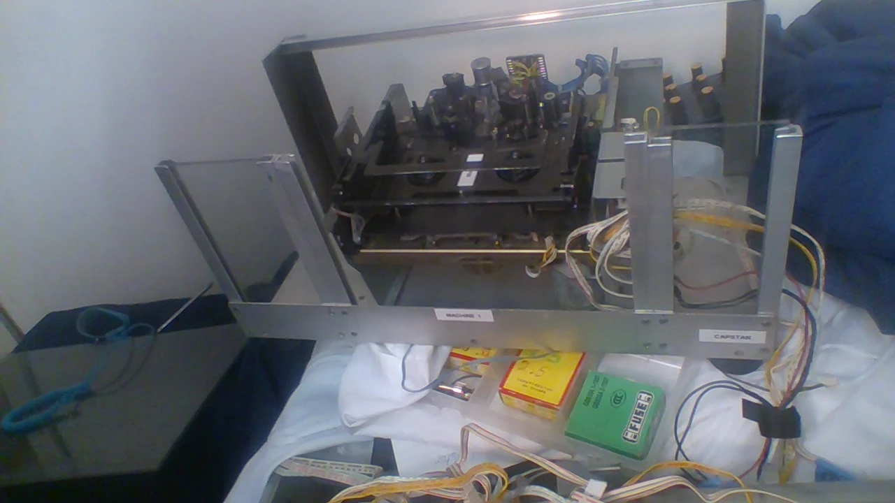

Currently, I have been building stand alone housings for tape mechanisms. Reason being, it seems an abusive situation to remove these things and back and forth 10x. This way I can observe and use in plain view. I have extension cords made and have operated this remotely, but am still in process of working all this out. I recently, FINALLY got the wave form I was looking for on my oscilloscope. Has to do with the erase coil. After I got the waveform, everything went South, as noted above. I will try to post specifics on another thread. Essentially, by swapping boards between machines, I found an issue with the 100khz oscillator, and the beauty of having multiple machines, is I was able to see that another machine suffered the same issue.

The picture above where the transport is out of machine works really well. I have three working transports that can be swapped in and out in like a minute. All the springs and guts can be viewed as well. It was pretty simple to do and works well. Looks like crud, but personally I am fine with it.
