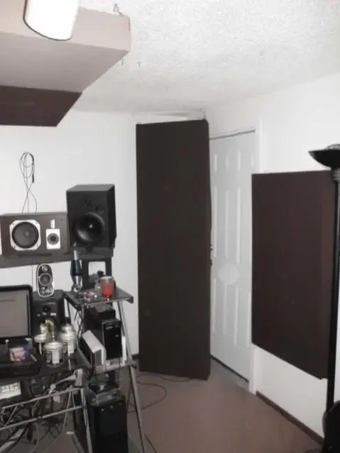

On a side note, I just installed two fire doors, and started install of the drum room ceiling joist fill of Roxul 80. And made my first trap with wood frame and nail gun! Friggen fast and sweet!! :D

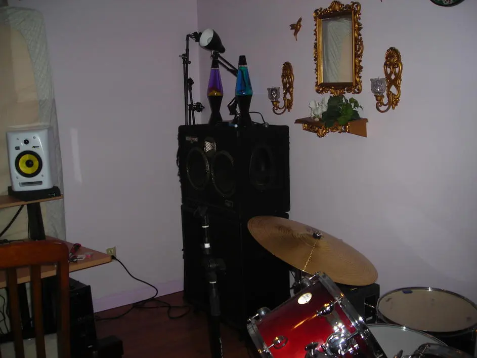

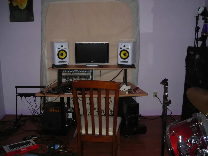

Found the camera!
No foam on the walls, moved desk and amps, and the burlap is in.

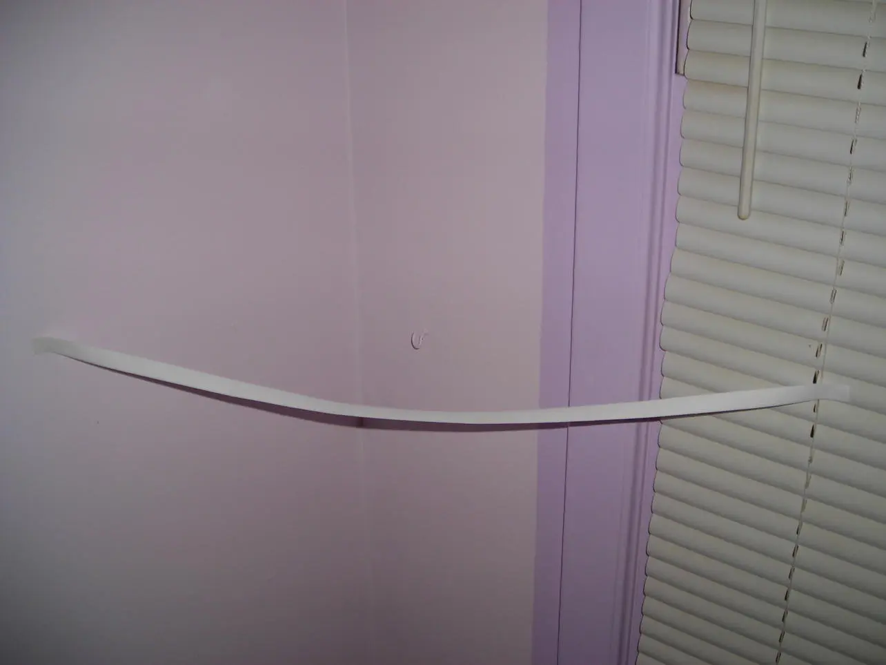

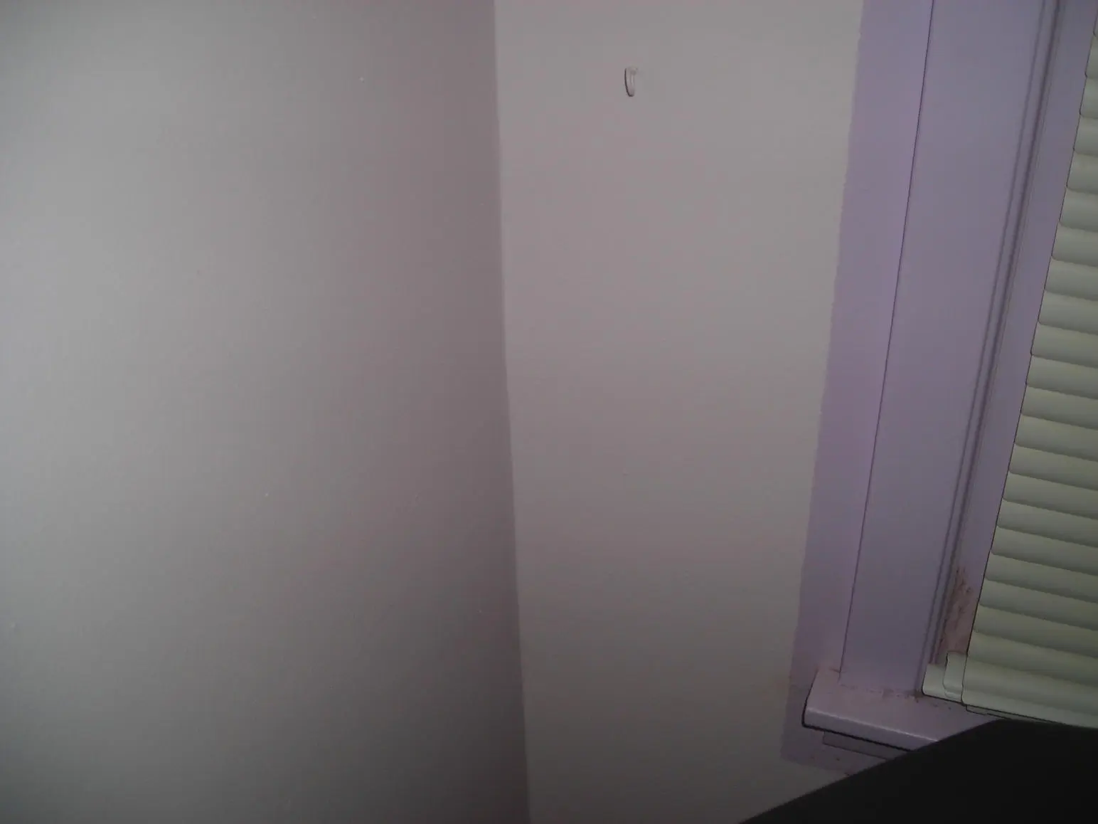

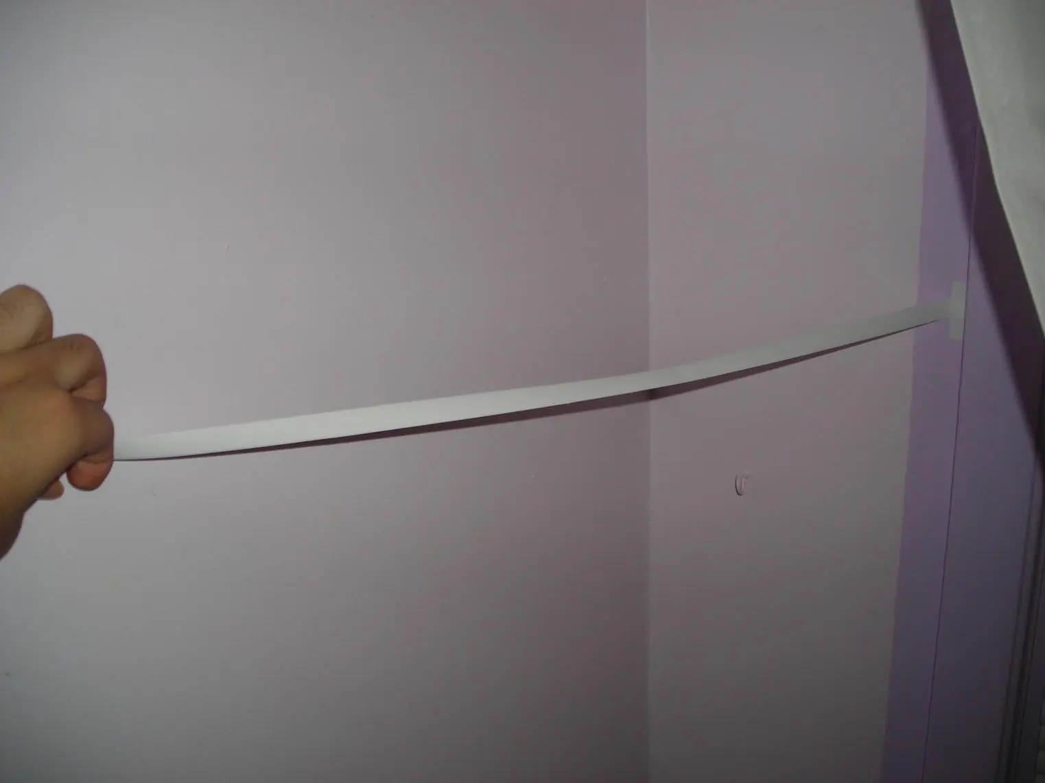

So here is my "trouble corner". I mentioned it earlier.
(Imagine we're looking down on the corner from the ceiling)
This is what I would encounter if I tried to build it and stuff it in to the corner like this pp-triangle.webp (w/o the tip of course)
The tape is aprrox. 24" like the trap will be.
Now since that would be a little weird, if i build a frame and put it to the corner like this still with 6" of roxul and 24" wide would it be a problem? 220px-Trigonometry_triangle.svg.webp
:confused:
Sorry if it's weird. It was my best way of explaining :o
This is what I would encounter if I tried to build it and stuff it in to the corner like this View attachment 68435 (w/o the tip of course)
Now since that would be a little weird, if i build a frame and put it to the corner like this still with 6" of roxul and 24" wide would it be a problem? View attachment 68436
:confused:
Bbbump?
Sorry man, been busy as hell.
If you must keep the window exposed, then using your plan would be better than nothing for sure. I have a similar situation, but with a door to my drum room. I just built a 4" thick 8'X2' panel that I just lean in the corner. Scoot it out of the way when need access to the room. When mixing, I straddle the whole corner.
No problem.
I just wanted to make sure it would mess anything up.
Since I've got to build two full traps before I get to that corner anyway, who knows? I might be able to seat a full one there.
Just trying plot everything out while I have time. Since Lowes STILL does not have my roxul.

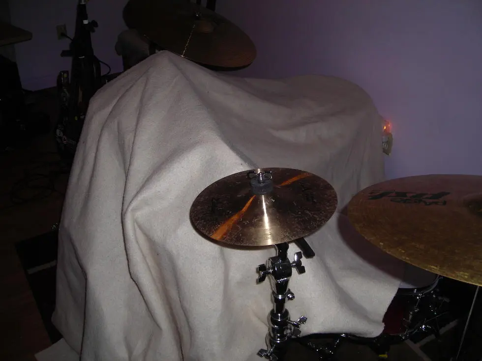

Resonating.
I never actually had the desk set up there. But when speaking the drums would resonate the sounds
Worst case scenario I suppose during mxing or vox recording throwing a light blanket over the drums would cut out the resonation.
:confused:
