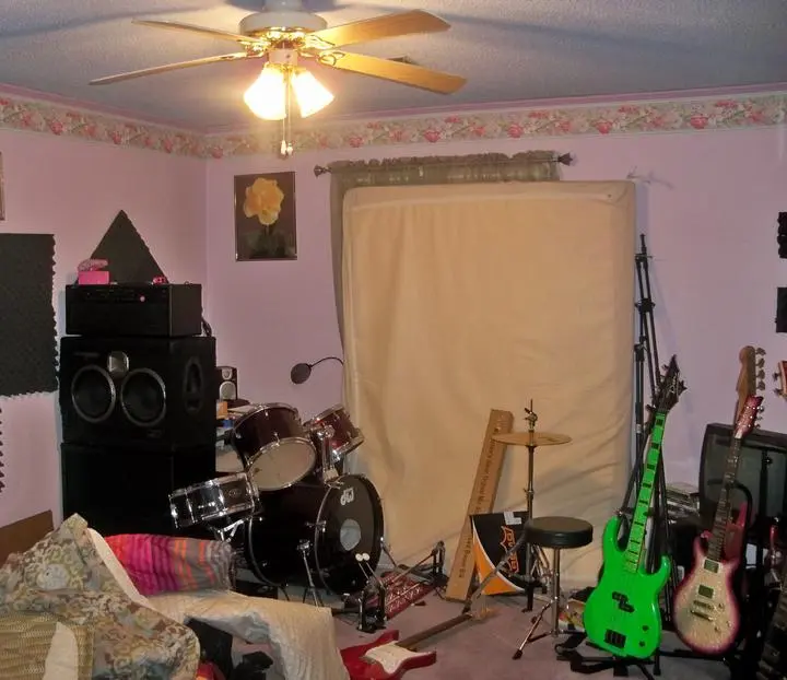

First things first- its taking up room. Since it apparently is useless and I plan on building stuff now. Should I take off all the foam and throw it away? Its been a year it was 70 bucks.
2.Diffusers? How necessary are those? Should I get to building?
3. Ceiling treatment?

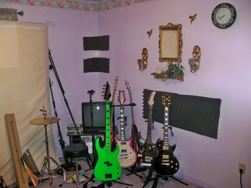

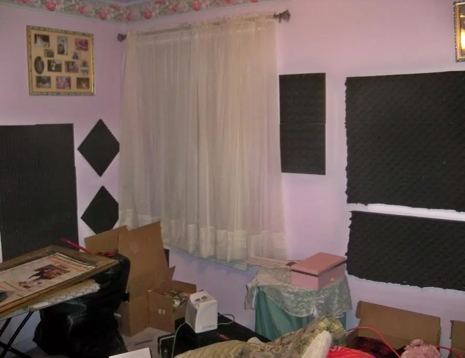

If it were my room, I would move the desk to the wall with the big window (treat it with a bare minimum of really friggen heavy blankets) and put the drums in the corner adjacent to the door. At least your monitors are front ported, so monitors against the wall will be a bit less an issue. I don't see you having the room to move them out much. Definitely follow acadeko's corner treatment advice. With your limited space, you may want to consider treating the ceiling corners too. You definitely want a broadband absorber on either side and above desk at first reflection points. Having the hardwood floor, I would definitely treat the ceiling somehow. I have heard of using the drop in type acoustic panels, but I would build 2" rockwool panels myself. In my current room, I use foam above cymbals to stop those pesky sizzling reflections in the overheads, but I have carpet on floor now. The new drum room I am building has concrete floor and exposed ceiling joists 24" on center, so I am filling them with rockwool. Not sure you have the option of opening you ceiling up. That would be the most ideal. I found cloth for my new round of traps at WallMart for $1 per yard. Any 'breathable' material will work fine. Much bigger selection can be had a cloth stores like JoAnn Fabrics and such. My first round was for curtain liners @ $2.50 yd.
Keep the foam for spot treatment later. Diffusers are much more useful in larger rooms. If you were to build some, I have seen them made by just bending thin luan plywood in a frame (from above would look like a 'D'. Not sure where I saw that or how effective they are. Been meaning to research that.....
Is that thick memory foam in front of the window a negative, a positive, or a non factor?
As it is now I have this myth that it makes it tougher for sound to escape the window behind it :p
Well, the memory foam is a closed cell type. It will do nothing for the interior of the room as far as absorption. It may have qualities for limiting sound transmission to the outside, as mass is your friend for 'soundproofing'. Only real way to know for sure would be to test it. Either with a db meter, or by just listening outside with/without. It is good for guests to sleep on for sure. :)
I'm just gonna leave it there. I did some work in there today, including moving the desk in front of the mattress/ window area as recommended.
I finally am getting rid of those two cabs that i dont use for the greater good.

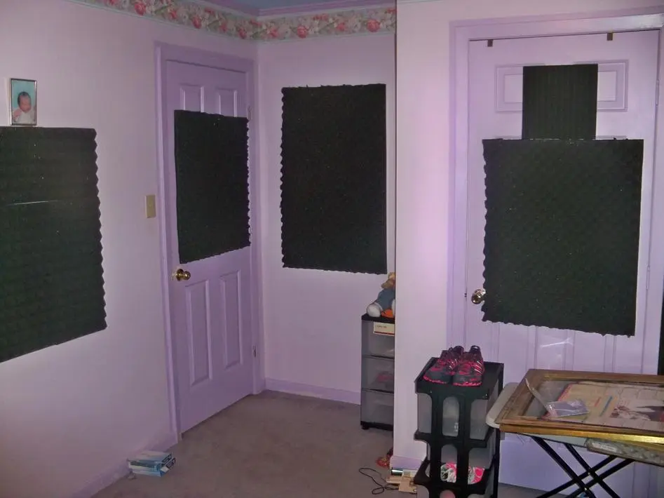

The doorway- Since i can really fit a floor to ceiling corner trap there. Should I make a tiny one, or make a floor to ceiling "freestanding" rectangle trap.
Trianle floor to ceiling trap on the 3 main corners, another triangle on the corner opposite the door- in that little alcove type thing- and then a rectangle one in the corner beside the door?

That is a strange spot that will be hard for any of us to judge. If it were me, I would put a typical corner trap in the corner between the closet and the wall to the left of door. As well as possibly a panel on the wall there. And maybe a 2" panel on the door. Keep in mind that if that is a hollow core door, it may not be building up as much bass frequencies as you might expect from a solid wall. Still, taking care of the other three corners is going to get you closer to an ideal situation. I would start with the obvious ones, and make a judgment based on testing of the room after treating them. See how it sounds then. When dealing with a room like you have, initial treatments will give quite substantial results. Base further treatment after you get the big offenders tamed a bit.
That is a strange spot that will be hard for any of us to judge. If it were me, I would put a typical corner trap in the corner between the closet and the wall to the left of door.(The corner we cant see in the picture?) As well as possibly a panel on the wall there. And maybe a 2" panel on the door. Keep in mind that if that is a hollow core door, it may not be building up as much bass frequencies as you might expect from a solid wall. Still, taking care of the other three corners is going to get you closer to an ideal situation. I would start with the obvious ones, and make a judgment based on testing of the room after treating them. See how it sounds then. When dealing with a room like you have, initial treatments will give quite substantial results. Base further treatment after you get the big offenders tamed a bit.
