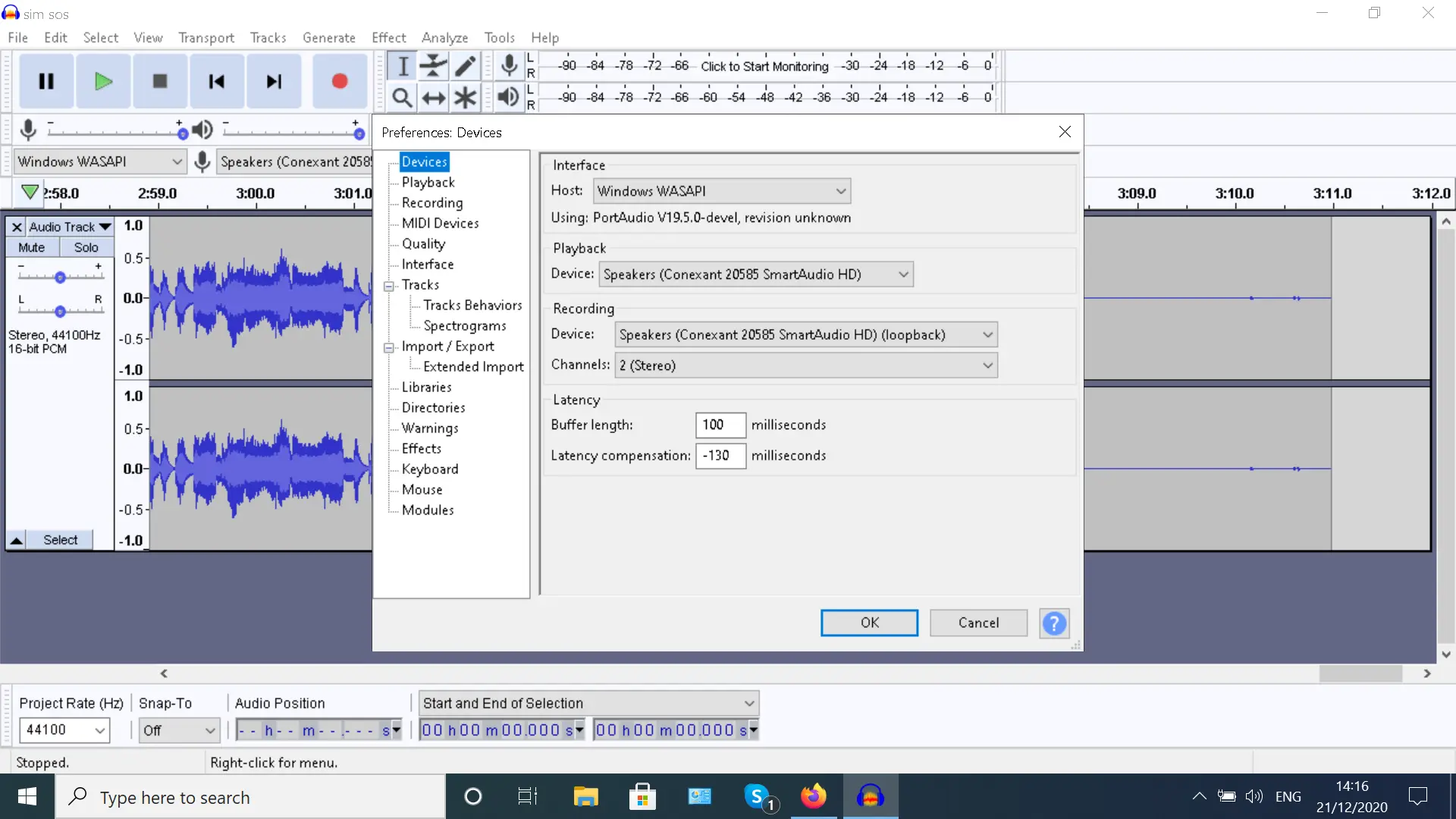

Setup Audacity ('Edit Preferences') as shown attached then it will record any audio going through the computer.
You used to have a function called "Stereo Mix" but Ms stopped it in W10. There are a couple of free apps that can do this but Audacity is way simpler and one less program to have on your hard drive. I use it all the time.
N.B. If you don't yet have Audacity, download it from the dead safe 'ninite' site.
