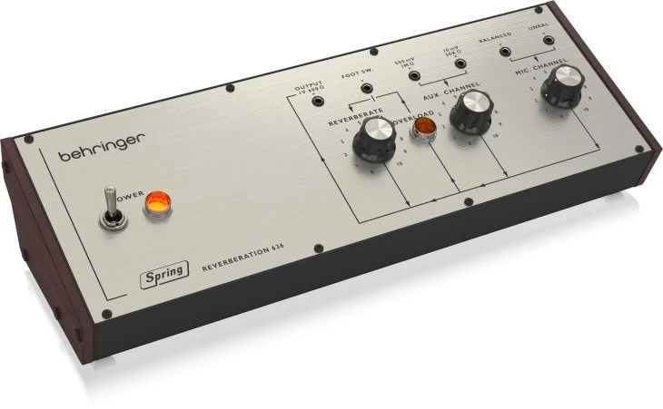

This is a new Behringer spring reverb.
It is exciting, because it costs around £160. Other Spring Reverb units can cost £2000+.

I know you were joking friend S but I would really like to know! We ARE talking Behringer here after all and it is possible that there is a digital circuit in there and it is really an "emulated" spring reverb?
If it is an actual tank then I hope they have not copied the very common amp circuit where the drive IC* is DC coupled to the drive coil? The very LAST thing you want is a very low frequency circuit driving a spring transducer. I have read several reports of drive coils going 0/C and have to suspect this DC coupling has to be some of the reason? Did tank coils FU in old valve driven Fender verbs?

*Almost always the entirely inadequate TL072. What is needed is at least a parallel pair of NE5532s and preff' a 'power' IC such as the LM386 which can drive down to 2 Ohms IIRC.
The dimensions could accommodate a set of springs and coils, but you're right . . . this is Behringer, after all.
