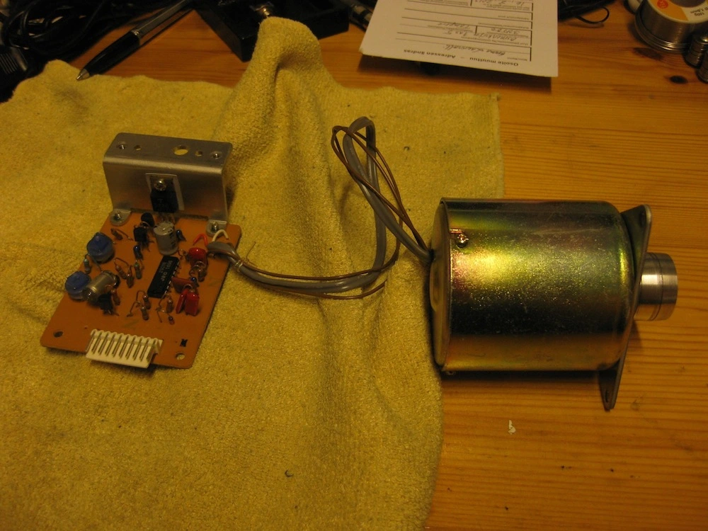

Here's the motor intact

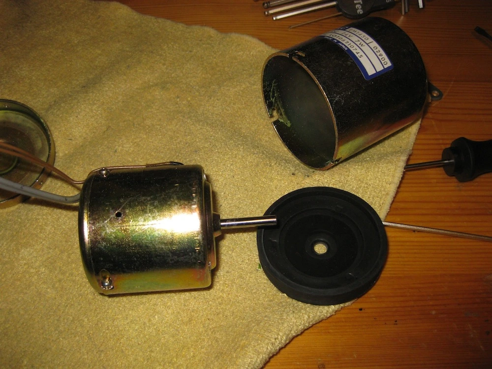

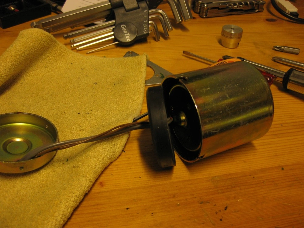

Taking off the outer shell
There's a second cover inside

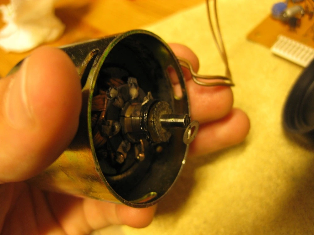

Getting to the interiors, here you can already see the commutators

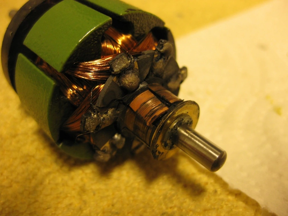

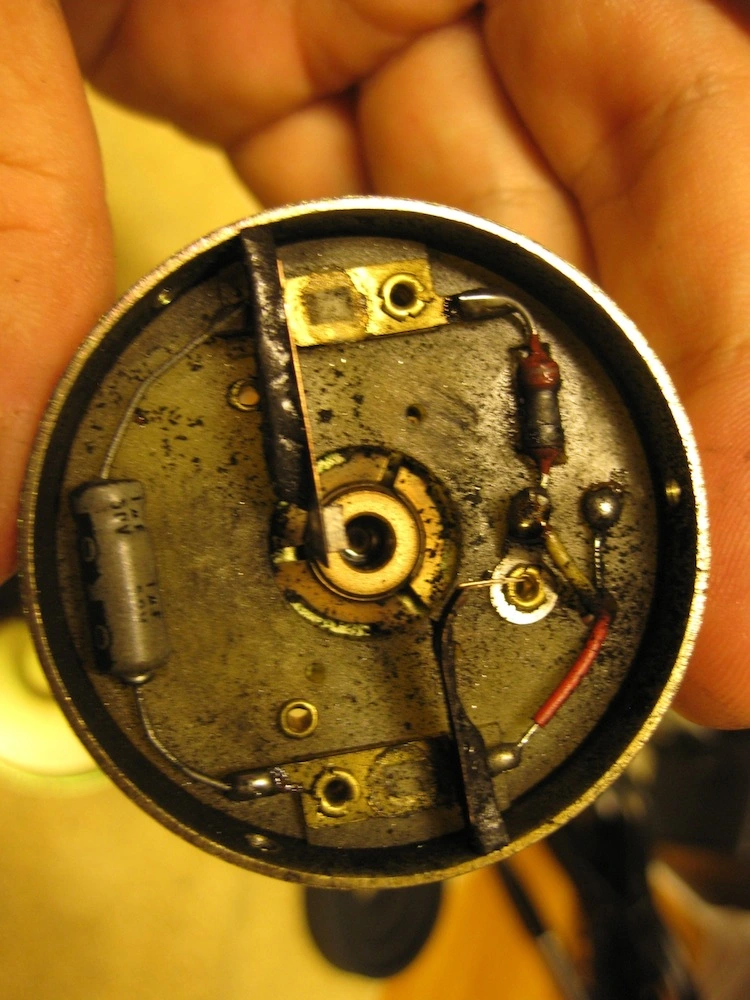

This is the part that goes against the part in the previous picture. The two arms extending to the middle of the circle are supposed to come in contact with the commutators. The one starting from the top is straight, as it should be, but the one starting from the bottom is bent badly to the right. Also, a small metal piece (the "brush"?) is missing from end of the the bent arm. The backsides of the arms have pieces of rubber attached. The rubber from the bent arm has melted, and caused a mess in the commutators.

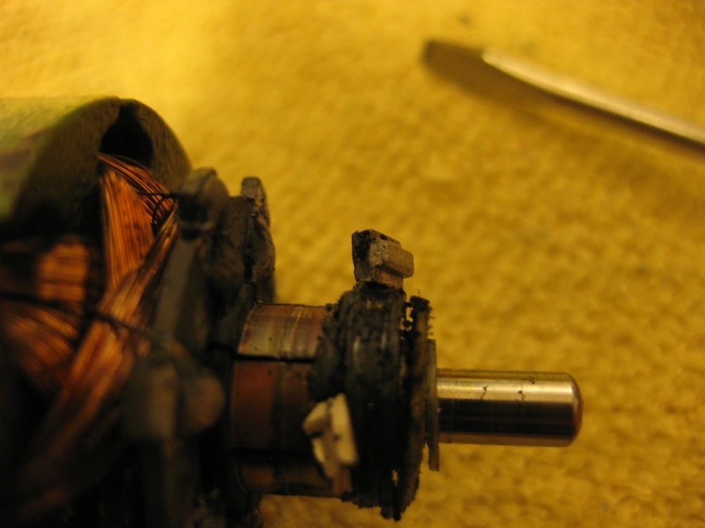

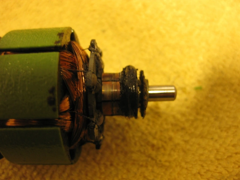

A close-up of the commutators. The black goo in the middle is the missing rubber coating missing from the previous picture. Also, you can see the missing metal piece from is stuck to the rubber mess.
So, the way I thought about it, I had two main problems. First of all, the melted rubber, and secondly, the badly bent commutator arm with the missing tip metal piece. Luckily, I was able to bend the arm to its original shape quite easily, and the metal piece was intact. The problem would be to connect it to the arm. My plan was actually to try to solder it from the back, but I didn't get a change to try this yet.
For the rubber mess, I took a box of Q-tips, and some isopropyl alcohol. I actually got it off reasonably well, but then I ran into other problems.
I guess I was applying too much pressure to the commutators, since the ring around the basis of the commutators started cracking, and seems the material is so fragile that it's just a matter of time when it all falls apart. This ring was actually holding the commutator plates in place. I didn't realize this at first. You can see the damage from the next picture. It would be nice to be able to glue the broken disk back together, but it seems too fragile, that I probably have to admit my defeat.
