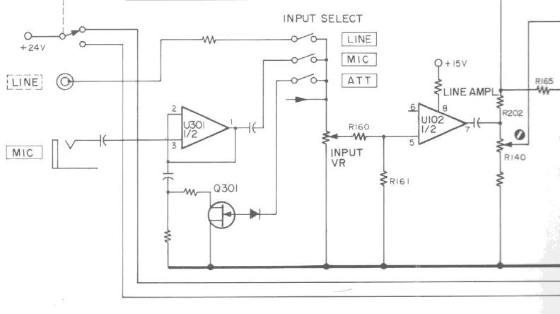

i'm just getting into recording to analog tape. so i'm starting out with a tascam 32-2. i'm still tracking digitally with a presonus firepod but i want to be able to mixdown to a 2-track tape rather than bouncing down in Logic.
so, should i just turn down the master output volume on my firepod to make sure my VUs on the 32-2 stay below zero?
mishagolin said:
i'm just getting into recording to analog tape. so i'm starting out with a tascam 32-2. i'm still tracking digitally with a presonus firepod but i want to be able to mixdown to a 2-track tape rather than bouncing down in Logic. so, should i just turn down the master output volume on my firepod to make sure my VUs on the 32-2 stay below zero?
You should have no problems just running XLR - RCA with this setup. Your 32 has an input level control before the first op-amp, so you're not going to overload anything by starting with the level control at zero in 'input' mode and then slowly bringing up the level until things look good.
