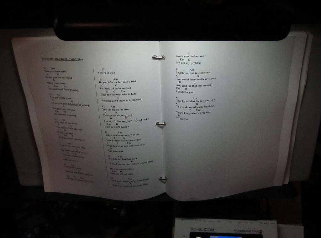

For my overseas 'mates' with the accent....
Pretty much 100% guaranteed no hum or buzz and ideal for reading of VO scripts in the dark :D. I introduce to you.......
Wasn't in front of me so I had forgotten about it. I've got one of these clipped to the top of a music stand and I can't say I've ever noticed a problem with it inducing noise into any recordings when running off the AC adapter. It can also run on batteries which I haven't tried.
