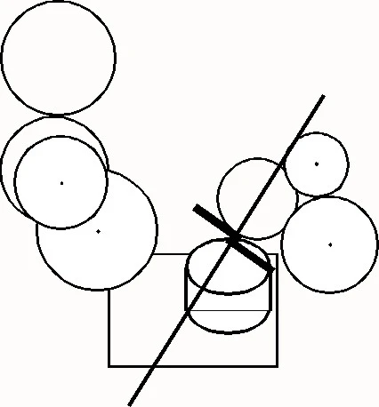

Stuff like that is why I don't like ORTF or X-Y. They give a natural image of the kit, but it can be skewed if you want the kick and snare centered like most normal people do.
Think of your kit as two halves. Imagine a line connecting the kick's beater contact spot and the center of the snare head. That's your center line. Adjust the left and right mics accordingly.
That's why I do this:
Snare is centered, kick hardly gets into the overheads so it doesn't matter, hats are pretty close to center (but a close mic can change that), cymbals are spread but not drastically wide, toms are spread somewhat but close mics can move them a bit if desired.

Okay, you hear how the snare is leaning to the right? And how it kind of sounds thin with a faint echo? None of that is good. You've got some imbalance and phasing going on.
Look at the illustration bouldersoundguy just posted. Think of your kit like that and set the mics accordingly. Do everything you can to keep the snare centered. Treat the kit as two halves and measure, if you have to, from the center of the snare to each overhead mic. It should be as close as you can get to the exact same measurement. Some people will say "the snare doesn't have to be centered blah blah blah". Fuck them, they're wrong.

Ok. I'll see if I can get it more ironed out tomorrow. I was delighted with how much better it sounded than the mono setup, but I knew there was no way I set it up "perfect", so to speak. If you were to throw an arbitrary number on it based on the results and say I was getting X% of all the sound quality I could get from this ORTF setup, then X% of stereo still beats the shit out of what I had. Of course, a pair of $200 condensers vs. the SM57 I used for the mono before... I'm sure the quality of mics also makes a difference.
Thanks for steering me the right way again.
