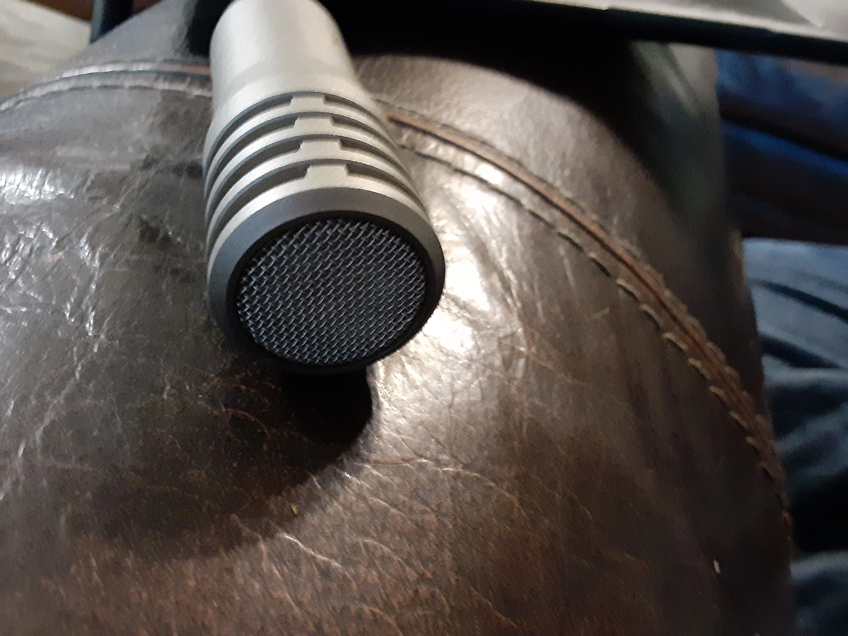

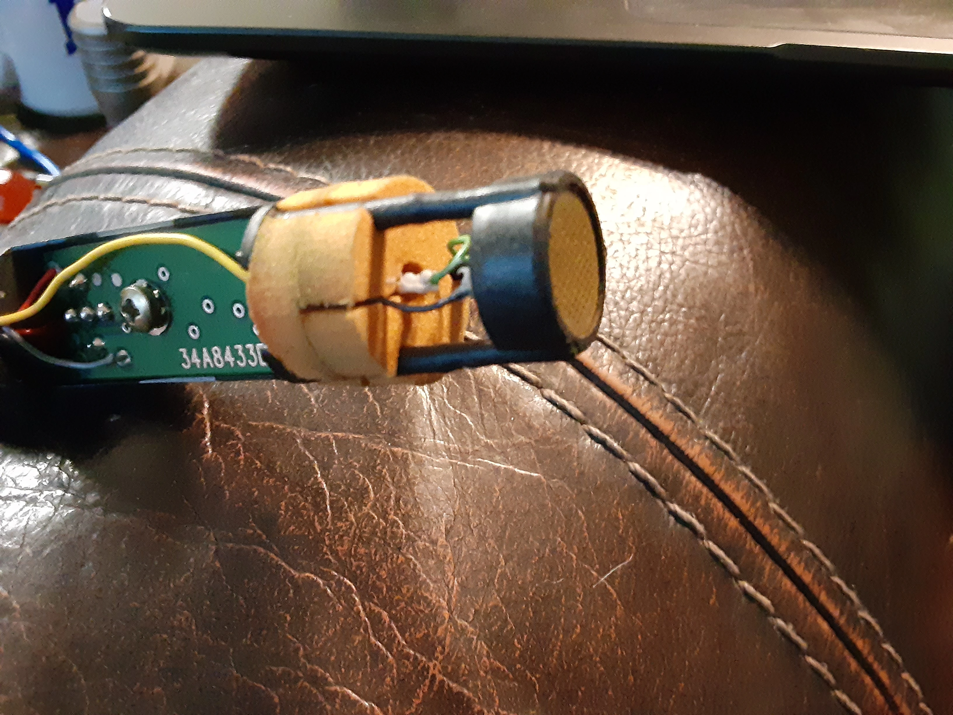

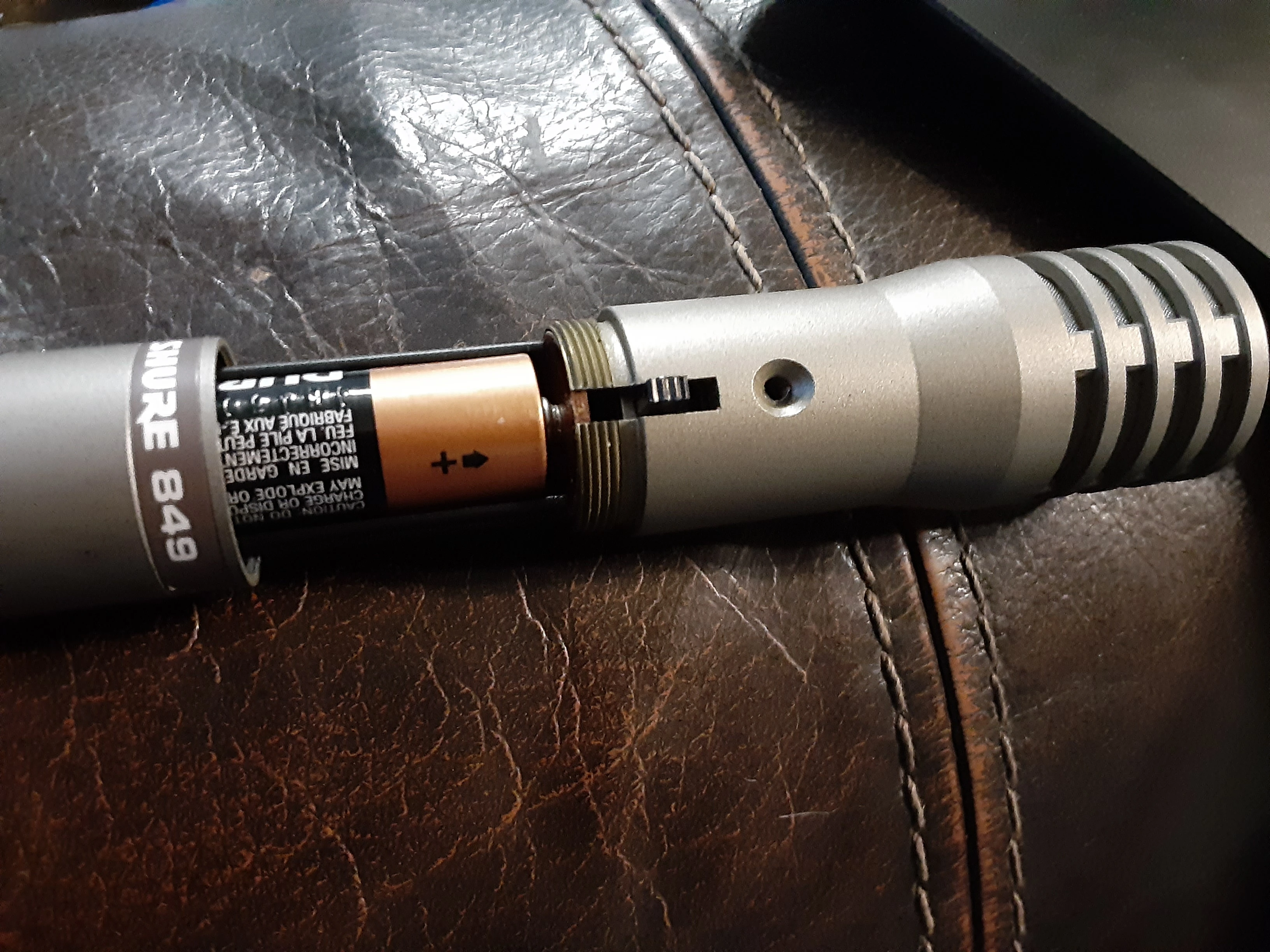

Why offer the 849/94? I think it was SM81 fame, but now with battery option!! powered and a on/off switch. The capsule looks good, and one improvement is the 894/94 fits in a standard SM57/58 clip, a more universal diameter...instead of the skinny body. Shure makes stuff for a reason and most likely they saw a market. You dont have to have a battery, Phantom 48 volts works.
The Shure 849 build quality are excellent, same as the SM81. Champagne, color with serious weight and paint that holds up well...Shure tank tough feel. I got a pair in at $120 pair, and in mint shape. Average price is $99 each used. So 2qty for less than one new SM81.

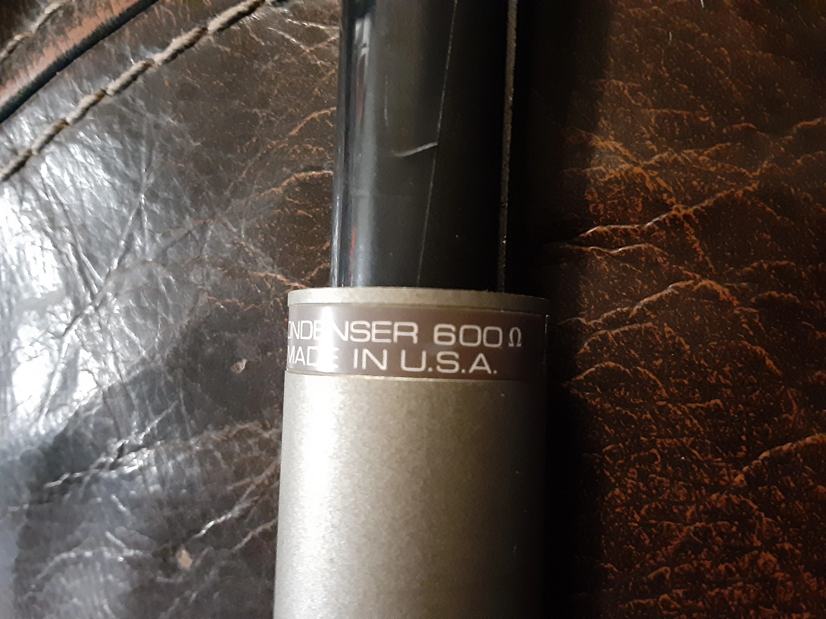

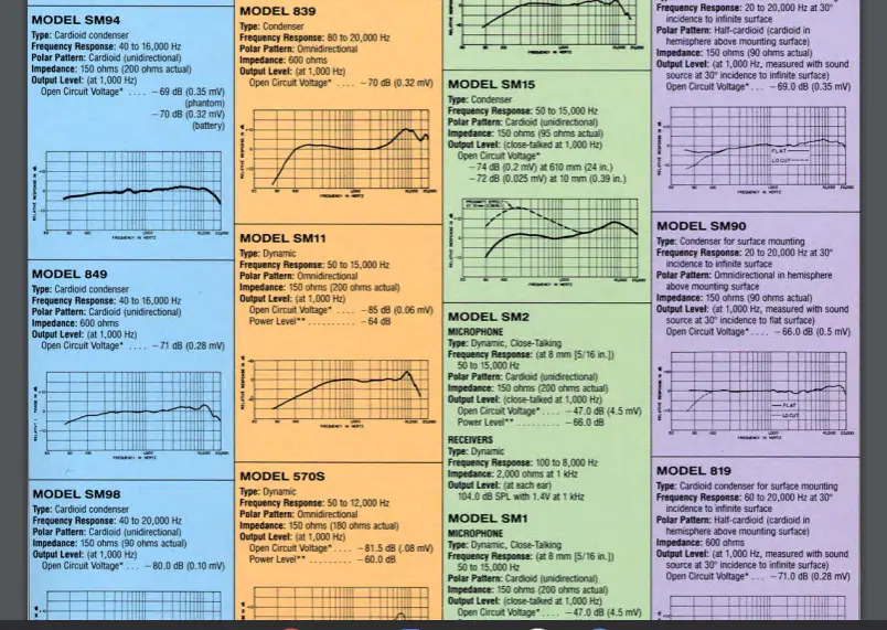

Shure doesnt even mention them unless lumped in with other mics , mainly the SM94. 849/94 overlapped and though the spec is near identical, the 849 is 600 ohm and the 94 is 150ohm. Why does Shure release so many models? Why 150 ohm and 600ohm?

Made in USA , Shure 849. Condenser , SDC ......from the land of obsolete marketed mics.

** After some more tracking and spec research, the SM81 is almost double the sensitivity(louder) and the 849 needs a decent amount of gain for acoustics on this a acoustic guitar. SM81/PG81 have sparkle like the KSM44 where the 849 is more detailed and similar to the KSM32. It seems flat compared to the 81 which seems to have a more eq'd sound. Probably might want a outboard preamp for the 849 at 2.6mv/pa....where the 81 is 4.5mv/pa.
