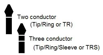

For future reference, TS cables are for mono signals and TRS (one more conductor than TS) cables are for either stereo or balanced signals.
Think of a headphone plug (TRS) versus a guitar plug (TS). Just put the 2 side by side and the difference will be crystal clear me ole China.
