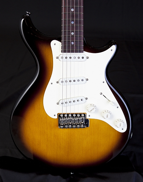

Cool, Thanks. There are three that I'm ready to get going on. One is a Bass for my Daughter. She wants one that resembles a Gibson RD. Another will be a non reverse Firebird I'm helping a friend with, and the third is a s type for me. I want to mimic the shape of this body. I need templates for all of them. I'd really appreciate any help you could offer.
I won't be able to work on these before Monday. Then, I'll see what I can do. Which first?
