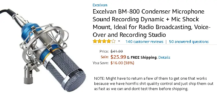

QC....thats interesting. Ship it back....maybe a few times?
The Behringer XM8500 dynamic you tried isnt going to help anything without a outboard preamp. It has -70db sensitivity. Thats less output than a SM7. I'd return that one.

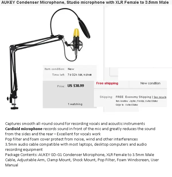

The AUKEY Condenser Studio Microphone GD-G1 should work fine, dont need a phantom power supply with the AUKEYGD-G1.
Looks like a good deal for $35 and all the extras. wow. The BM-800 is probably the same genre as the AUKEY too, probably same QC.
how do they sell the stand, foam, holder and mike and cable for $25-$45?

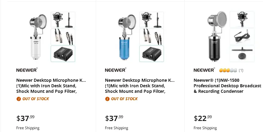

So this is the one you bought?
Neewer Mic and Phantom power and extras.
The AUKEY has a lot of youtubes the GD-G1 and doesnt need a phantom just the PC power with a 3.5mm plug.
But only works with some sources (pc or camcorders etc..)?
Its a cardiod and so front to sides has a lot of drop off in volume...speak to the front for best results.
However one guy has a youtube with very low output with the AUKEY GDG1, into his laptop but not his camcorder.
This also goes along with what Dave mentions above in trying another pc.
Interesting Ive never tried the $30 mics, amazing deal if they work. Never tried the USB stuff either but with USB 3 and USB C coming there will be much more power and current available and these mics will probably really benefit.
