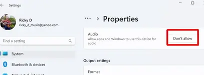

This probably shouldn't be set for "Don't Allow". Change it to allow and try again.
Also, FWIW I performed an extensive testing of microphones, only to establish that the problem has nothing to do with the mic. I got "clicks" with every mic I used; dynamic and condenser. AND (big and) I also detected "clicks" where there was no actual vocal signal (in other words, in between words) and I detected more of what I've called "ghost clicks" because when you rewind to listen again, they're gone. So again guys, I strongly suspect the interface box, but I need to get Reaper working to prove it. I suppose I could try another free DAW.
