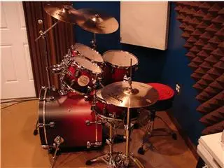

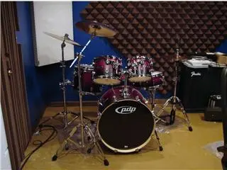

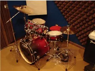

I've got a few pics loaded
Here's what the new ex-drum machine looks like.

Sweet Seeker!!! They look purple in the one shot. Can't wait to hear a sample of your new sound.:)
I don't know the official company color name, but the salesman told me "cherry to black fade." Regarding samples, I can't wait to tell my wife after charging $725(after the DM Pro kit trade, of course) that I need to buy a couple of 57s and something to mic the kick with :(:(:( I'm sure that's going to be a jolly conversation, especially with Christmas coming up.
