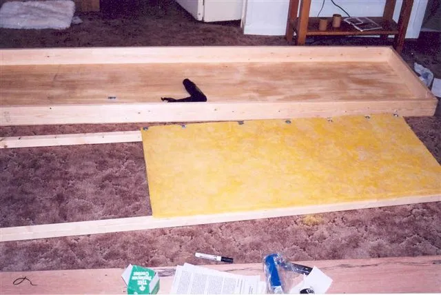

I told the neighbors that I was building coffins but really its just bass traps. It pretty easy to do. If you have a basic knowledge of quantum physics you should do fine. My only mistake was using a cheap miter saw to cut the wood. The edges don’t line up properly. I made the traps portable so I can move them from room to room. Instead of mounting them to the walls I just secured a very thick piece of plywood to the back and sealed the edge with silicone. A word of warning... don’t take a piss after touching 703 fiberglass!

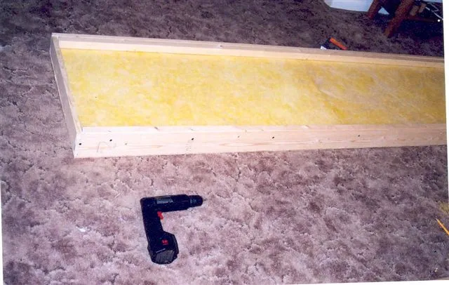

These things are portable but they are extremely heavy.

What thickness did you use on the plywood? Do you cover the front? What freq range do you expect to absorb?
I've got a bunch of 703 left from my panels and am just waiting for cooler weather before I start the next project.
The front of the trap is 1/4-inch plywood.
The back is 3/4-inch plywood.
Inside the trap there is a 1'' gap in front of the 703 and a 2'' gap behind it. The trap is completely sealed with silicone.
The surface is just bare wood since I don’t need to cover then with anything.
I believe this type of trap is designed to reduce very low freq. I will also assemble other traps with different dimensions to trap mid bas freq.
I have a feeling that not too many other people use bass traps since I don’t hear much about them.
I will probably put the deep absorbers in the corners and the mid- bass absorbers along the side walls.
