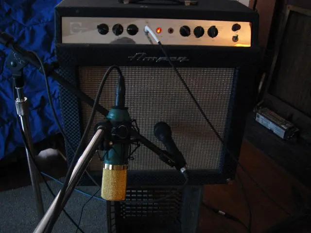

Hey, I found pics! Here's guitar amp 1:

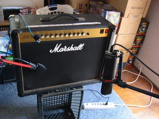

Here's guitar amp 2:
Hey Madz,
Is there a particular reason you have the amps lifted off the floor. I always prefer to have them on the deck, especially if they can sit on a wooden floor.
Gorty said:
Hey Madz,
Both amps were in my bedroom, and it seemed to help with bleed.

Gorty said:
What are those boxes in the corner with KISS on them Madz??
Damn!!!!! That looks like the boxes for the KISS action figures. :D
