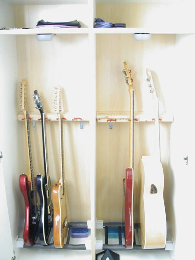

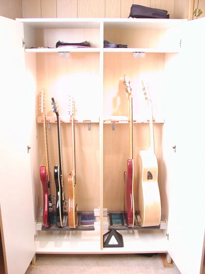

I keep my guitars in a custom-made guitar cabinet all year round. This way, I know that the temperature and humidity remain at a constant 72 degrees and 66%, respectively. I bought the cabinet from Ikea for only $99, assembled it, and then customized it accordingly to hold 7 electric guitars and one acoustic.
I put a couple of home-made humidifiers (made with plastic containers, anti-microbial sponges and filled with distilled water) inside the cabinet at the bottom (in the back). I also put a combination thermometer/hygrometer inside to monitor conditions. The cabinet also has a pair of lights inside for the "wow!" factor. :D

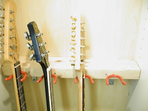

I used grey foam pipe insulation over the bracing at the bottom to prevent scratching or chipping the bottom of my guitars. I used some cheapo rubber-coated garden tool holders from the hardware store to support the necks. Total cost was about $150 for the cabinet and construction materials, and another $20 for the thermometer/hygrometer. I use a plastic kiddie-lock on the handles to keep the kids out. There's a storage area up top for guitar cables, tuners, pedal and effects, etc.
Here's what it looks like... (with doors open, of course)

Very cool Buck. I could convert my studio closet to something like that and keep most everything out. Then again, that would defeat the other reason I keep them in cases...........earthquakes.
