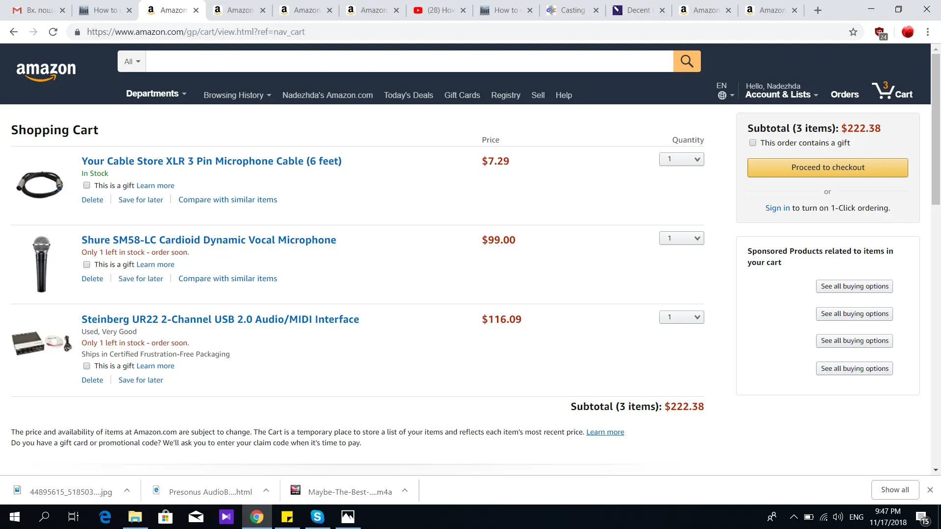

I took this cable and the microphone, however, couldn't purchase the interface because they don't deliver it to Hungary. Would I be able to use the microphone with a good sound quality without the interface?
Thanks!
Both Thomann (EU) and Gear4Music (uk) deliver to Hungary. I dare say plenty more? Oh! No, it won't work an interface is basic equipment.
