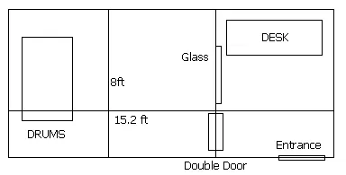

Hi guys! How would you treat this rooms?
8 x 13 x 7.2 ft Drum recording room... Is a typical room within a room made of gypsum with wool behind...
8.5 x 7.2 ft room with an angled wood ceiling... (11 to 7.2 fts) Control room...
Look at this basic scketch...

that's a small room.
you'll need as much absorption as you can get probably.
Thanks! Anything else? I was thinking on 2 bass traps and a 4 panels of 703 for the Drum Room and the same thing for the control room...
Any other suggestion?
If you are going to go out and get 703 build your own bass traps too, since you will have to buy whole bales of 703 at a time.
I would put floor to ceiling corner bass traps behind the drums then a pair of wall mounted absorbers behind the drums and then begin adding staggered panels to the side walls until it was enough.

Thanks Innovatios! I was thinking on something like that...
And the same goes for the control room, right? Bass traps behind monitors, and 703 on the sides and behind the desk..?
Thanks guys...
