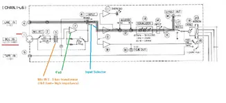

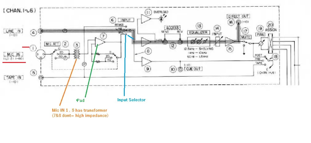

It looks like 1-6 is low impedance and 7&8 are higher, have your tried changing the input?
Seems theres only a fader for some gain and the rest is a low level audio.
it looks like a fun mixer, the manual is >40 pages!
From reading through the manual I don't see any preamp gain.
The Fader is a attenuator and the only gain seems to be 14db.
I only followed it through the front end. The Direct Out, the Submix etc....I have no idea, too much! lol
89 page manual!
