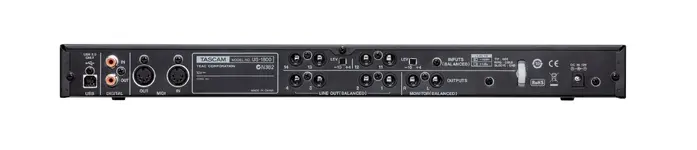

And here are pics of the front and back of my interface. Tascam US-188 Front.webp Tascam US-188 Back.webp
So what plugs into where if I still want to record all tracks dry and somehow have a copy of all the tracks with the wet signal results? Would it work for more than one mic at the same time? Or do I need to wire a single mic to this, then the interface, etc?
Also, the description of this BBE unit on their website says that it's perfect for unbalanced studios, etc. So would this even be meant for my type of setup? My setup is "balanced" because I run two 1/4" cables out from the interface to stereo monitors, right?
Please let me know if you can help. Thanks!
After you have the track recorded, you want to set up your outputs in your DAW. Although I think it's already done with the Tascam. Plug the line outputs of your tascam into the inputs of the BBE and then back into the line ins of your tascam.
You route it how YOU need to route it. If you want it on one signal, it'll be on one signal. If it's a 2-channel unit, you can use it on 2 channels (if it has independent controls on each channel, you can use different settings on each channel). Otherwise, output goes to input.
And you're balanced if you're sending balanced signals down balanced cables. The number of them has nothing to do with anything, the type of cable is somewhat involved (you can run an unbalanced signal down an balanced cable but not the other way around without having issues).
If the unit is unbalanced, you're going to have to set your interface to handle unbalanced (-10) on that particular routing setup.
