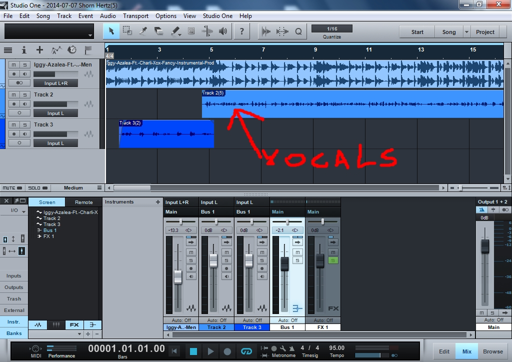

Using studio one pro to record vocals, i have my focusrite 2i2 knob all the way down, so as to not exceed -12 even when the singer/rapper is shouting. At this level the input is super low, you can even tell by the build of the wave forms.
Should i crank it up? or it is okay to let the singer put in a powerful performance and not peak past -12. help please!

The meters are the important reference point. The visual representation can usually be zoomed in/out.
If your meters are peaking at -12 or whatever safety point you've chosen, don't worry about how the waveform looks.
Arguably, the most important thing is that you don't clip and the second most important thing is that you don't hear hiss/noise.
Steen says true, if you're recording at 24bit, you have a lot of headroom. As long as it doesn't hiss when you get it to matched level, you've got a good track. It's not about turning the knob all the way down or half way up, it's about making clean unclipped data.
Turn your backing track down 16dB or so using whatever is Studio One's equivalent of Clip Gain. Then turn your monitors up 16dB or so.
Aim for average levels of -18dBFS on all tracks (maybe lower on percussive sounds).
Assuming that all of the tracks shown are at the same zoom level.....the track at the top is substantially louder than your vocal.
How did you get that nice, healthy level for that track...and yet such a whipmy vocal level...?
Is the top track a recorded level, or did you pump it up after the fact?

The top track is likely a mastered (or at least highly limited) backing track that was purchased or downloaded. He already turned the fader down 13dBFS, but that does not affect the waveform representation of the imported track.
