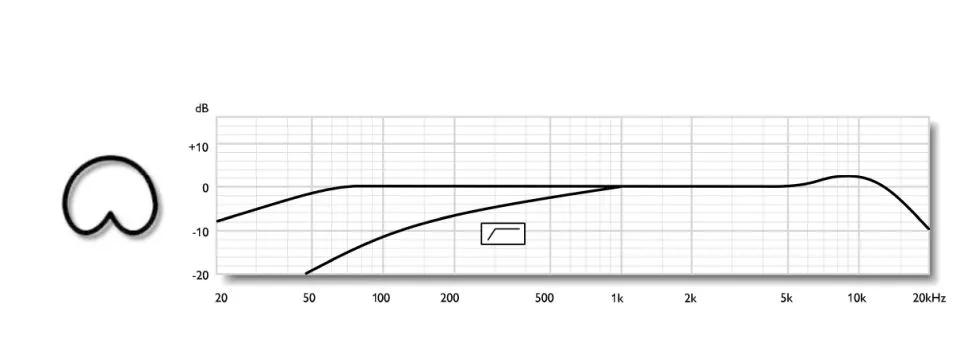

Microphone specifications tend to be about as loose as a cow with amoebic dysentery. Even some big names and high cost mics leave of frequency limits and such data.
You're very correct on this. This is the published "20-20000" frequency response for a very popular microphone. Its down 10dB at both 20 and 20,000Hz. It's +3dB at 8-10K. If this was an amp or interface they would be thrown out as junk! They are typically +/- 0.5dB or better across that range.
Oh yeah, it's the reponse curve of a Neumann U87.
Heh! Well to be fair I was more referring to specs that just give a bare "25 to 18kHz" with no decibel points.
And! Be careful what you say about U87s over here, liable to get beaten to death with a mic stand!
That's exactly what Neumann states for it's specs, no +/- dB listed. From their website:
Frequency Range 20 Hz ... 20 kHz

Also look at the distortion ratings vs SPL. 0.5% at 117dB. Since the 10dB pad increases that to 127, then its obvious that the THD is coming from the mic circuitry, not the capsule.
Some would say this is euphonic coloration, and it probably is. There's absolutely nothing wrong with choosing something that sounds "better" or "natural". Its just not necessarily the most accurate.

IF you want 20 to 20 +&-1dB (and beyond) you can have it. Called "measurement" microphones. Most of them are bit noisy though because they perforce use tiny diaphragms.
The trouble is, for some products a flat frequency response is the claim to fame, and for mics, the last thing they want is a flat response - unless it's for an analyser - and these mics usually sounds horrible for music.

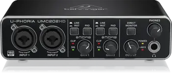

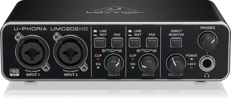

Interestingly enough, even though i am trying to understand HOW and WHY having the PAD-button 'ON' for voiceover (i don't use instruments), i cannot see if it's useful or not. When do you know how to use the PAD-function? Any examples? Does it matter whether i am using a dynamic mic (phantom power off) or a condenser mic, or?
And direct monitor-button on the 202HD.. That button is if i would have speakers/monitors connected to the AI, correct?
Sorry for "re-opening" these old threads, but i still don't know the answers to those things, hence why i am still wondering...
The pad switch is used if you are going to record a very loud source, or if you are getting a very high level from a line input.
No. It doesn't matter.
The direct monitor button sends a signal direct from input to output on the interface. It provides zero latency when recording. It is an alternative to software monitoring, i.e. the input goes into interface, into computer, back into interface, then to output.
You should have speakers connected to the interface anyway. It should be the hub for all inputs and outputs.
