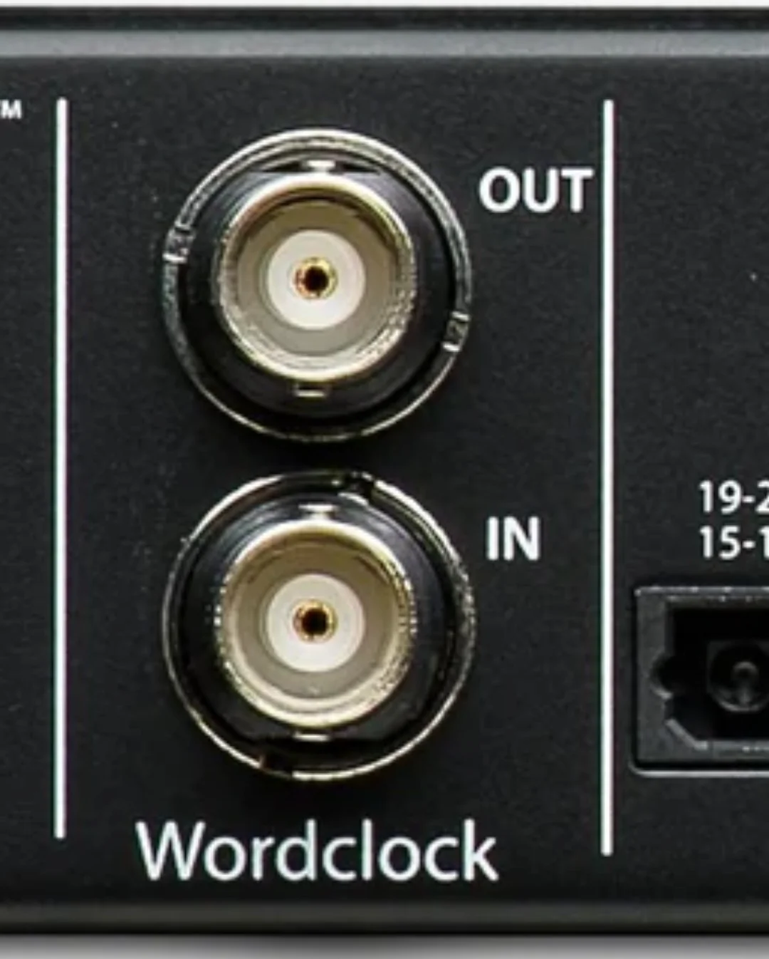

Thanks guys, How would I hook it up with BNC word clock? There is a in and out on each interface?
Probably a basic 75 Ω RG59 coaxial cable terminated with BNC would be fine. Connect output to input. You may need use the Presonus app to set the receiving unit (slave) to sync to external word clock, specifically the BNC input (rather than the optical input or the internal clock).
