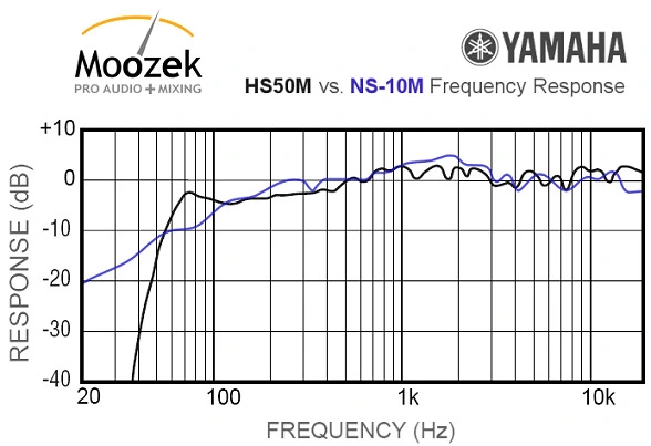

Does this help at all?

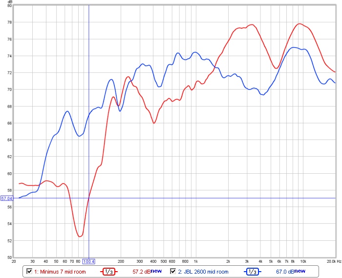

Here's my measurement of a Realistic Minimus 7 and a JBL 2600 for comparison. It was done indoors and you can see the similar room effects on the two plots. Nothing changed between the two measurements except lowering the stand slightly to accommodate the JBL's greater height. Mic distance was 1 meter, gain was not altered.
Maybe I'll get a chance to redo this outside for a more accurate result.

Thanks for the measurements Boulder, very cool!
