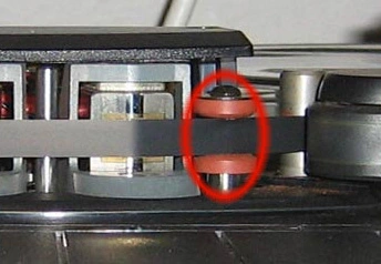

What do you make of what appears to be an "oxide line" at the top of the tape path, especially on the two rollers at either side of the pic and the capstan? Is it possible that there's either something abrading the top edge of the tape or an alignment issue affecting it in that area.
ChrisO :cool:
Not sure, but yeah if the reel tables are too high or the guides too low, or both there could be some excessive rubbing at those points. Also the upper part on the rollers could be easier to miss while cleaning so might have some buildup. The oxide on the capstan is pretty even, which is typical of shedding tape. IMO, this is way to much oxide comming off regardless.

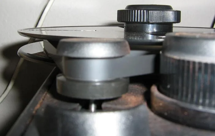

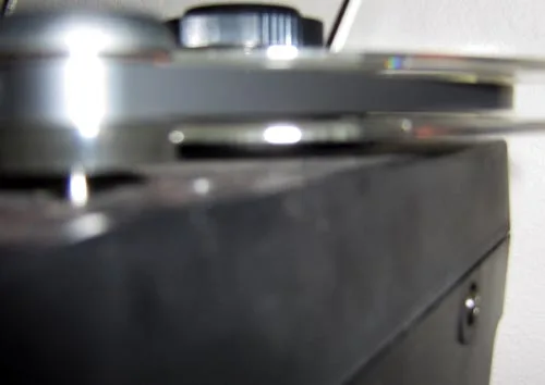

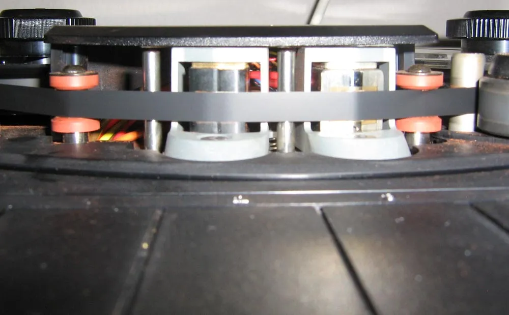

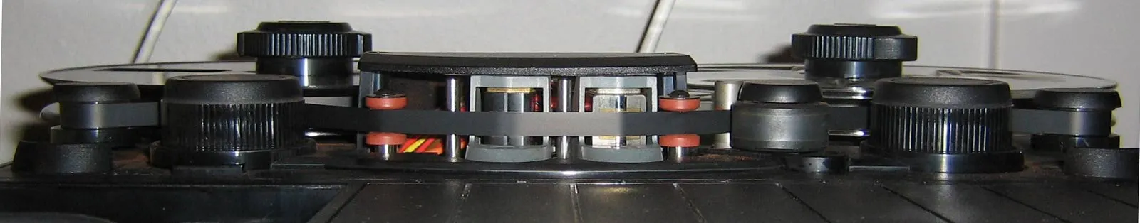

Im in the process of playing the tape front-to-back and that should rule out (or point me in the direction) of the tape lifters and guides. Ive attached some pictures to show the machine with tape playing on it, if that helps at all.
After looking through the service manual, the only maintenance I see is adjusting reel tension, etc, which requires tools that I do not own or have access to. I see nothing about adjusting the tape path? Ive uploaded the manual to rapidshare in case anyone wants to take a look at it as well. Please let me know if I somehow missed something important. http://rapidshare.de/files/39474645/R8_sm.pdf.html

nddhc,
It looks to me like the right guide needs to be adjusted out. If I look at your rec/repro head the tape doesn't appear centered. It may be getting pulled against the top (in the photo) of the guide causing some of the shedding. I'd raise that guide, and wait fr Phil Paske's call.
