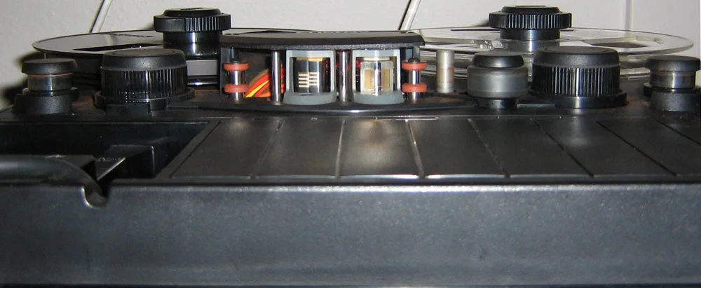

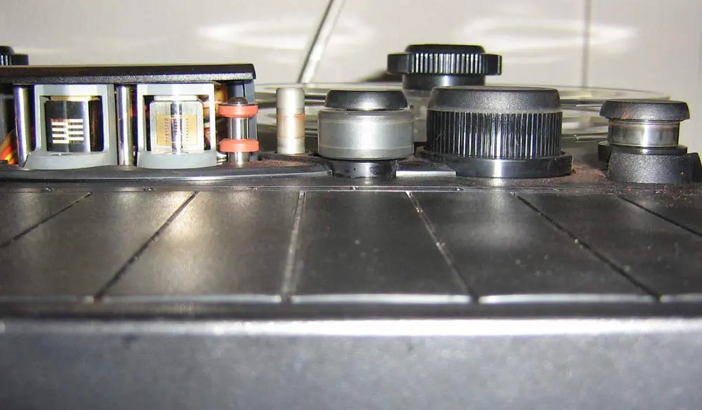

I bought the tape from Media Distributors in Studio city, CA last week. Ive attached some pictures of the heads and tape path. I appologize for the quality, I could not get any closeup shots that would not come out blurry. This is as close as I could get.
You can see some oxide dust on the surface and also some stuck to the erase heads and other parts. You guys will know more about this than me. Since it has been sitting unused for such a long time, a proper service and alignment is most likely a must and I will be getting that done shortly. However, if its worth anything, for the past few years it has been sitting in its original plastic wrapping and Styrofoam in the original box.
I am not the original owner, but I did pick it up for a great deal and wouldnt mind putting a bit of money into getting it running as it should. Please let me know if anything looks out of the ordinary, I sent all this info to Phil at RMGI as well and am awaiting response.

Hard to tell the tape path condition from the pics. do you have a manual for the R8?
Yeah I have both the user and service manuals... is there anything I should be looking at?
Most of the residue appears to be at the "top" of the tape path on the roller at the RH side of the pic, also a similar deposit on the capstan. One of the guys familiar with this type of deck may be able to interpret that and make some useful suggestions.

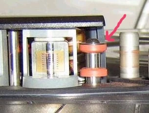

That’s way too much oxide shedding for any tape, especially new stock. I don’t see anything obvious that should cause a tape to lose oxide to that degree… except for one thing. What are those funky red washers on the guides? The only R8’s I’ve seen have all metal guides in those positions. The ones in your pics look like someone put faucet washers on them. Unless Fostex changed that part in later models. But if that's soft rubber it's a really bad idea.
One more thing to check is the inside of the plastic reels. If the tape is rubbing on the reel and there is a sharp protrusion from a poor injection molding process it could be tearing up the tape.
It’s a good idea to have a reel or two of different 1800ft tape around like Scotch Highlander, Dynarange, Maxell 35-90, Ampex 641 or even Radio Shack. It doesn’t really matter what it is as long as you can tell RMGI that it’s not your machine because you have other brands of tape that don’t shed.

nddhc, there should be a section in your service manual regarding machanical tape path alignment/adjustment (not electrical alignment). Find that section and look it over. If you are comfortable with it, getcher tools and go to work checking your tape path. If it seems intimidating, take it to somebody you trust and personally deliver and pickup...don't subject R8 to the merciless shipping minions!!! :rolleyes:
Really though, mechanically aligning your tape path is one of the easier tasks to do on an atr, especially if you have that service manual, so I'd encourage you to get the experience yourself. It is very rewarding and saves dineros!
Is there any way you can get a closer shot of those heads? It looks like there is some grooving but I can't tell. If the heads are smooth and the profile is rounded (not flat from wear), and you have gummyish oxide building up on the heads dropping your repro levels (and record levels too) that sounds awfully familiar to me...that is exactly what I went through...acually had record levels drop to infinity on a couple tracks while I was trying to do an electronic alignment. :mad:

What do you make of what appears to be an "oxide line" at the top of the tape path, especially on the two rollers at either side of the pic and the capstan? Is it possible that there's either something abrading the top edge of the tape or an alignment issue affecting it in that area.

The plastic reels are smooth on the inside, and the tape is wound and playing perfectly center on the reels - not rubbing against the walls at all on either reel.
