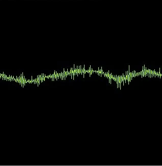

When i first got my Daw going with the Apollo. I tried some basic tests, that from the analog board work , but not from the DAW. This has to be the ASIOs or driver sound card related. Setup error.
I tried coping basic feedback . I could not. A test tone or two from the PA to the DAW, and again different.
How do I copy this? Copy these waves , see if you can. Feedback is really hifidelity and a good range test. Use meter and O scope. -16 LUfs max. Ya, I can sample it and straight up copy, but the Apollo is supposed to model the 1073 neve. It should respond , no?
This is what Im getting on the scope.
freeze.
No perfect sine or wave anywhere.
With tape there was a test tone that you could setup and match to. Start from somewhere.

Man, I seriously have to state that you are again looking to create a perfect something that does not exist.
There is no perfect sine wav and no preset is going to work for every voice/instrument/situation.
Things like presets from some software can help initially as a starting point, but you have to find what works for you for yourself.
Not anything ever works for all every time. You gotta listen and make your own judgments on what is needed. Don't throw in software as if it is needed just because it is there...

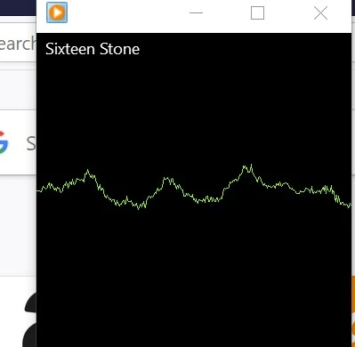

Awe man... The DAW cannot make a sine wave? Why because it is digital? I was told a 44.1khz mix makes a 'perfect sine wave' in my newbie thread. So I have been trying to make it with 1/4" and XLR's . I was wasting my time cause it cannot be done. Wonderful.
I wanted smooth, solid, nice, soft, full, waves. Not this
Well yall can see my recorded information looks nothing like anybody else's. So I am going to assume that there is a problem. You already know I do not know anything about recording. Some fragmented memories of my youth perhaps.
This aint mic placement.
A sine wave should be recordable without room treatments, so I m gonna hold off on that one. Sines out on my 8trk.
Levels. Ok. Perhaps, but these are not clipping or even hot tracks.
Compression or no compression? 6 dry natural or 12 dolby hi band compression. I say 12.
I put away the mics and this is all VSTs from UA. It sounds decent. I guess. Doesnt anybody else see the waves? Want to ride them! To the end. In one straight shot at the speed of light. I could spend an entire afternoon making waves in the O scope with different instruments. Peaks and valleys. Places to hide love.
If this is all it is. Let me work with it and see how I can make it MORE. The reel to reel makes better waves on the O scope, and that DOES sound better to me. I want to attach my 8 track to my Apollo. Go Hybrid.

Well, your Apollo only has two inputs, if you want all 8 tracks coming out of the tape machine, then you will need 8 inputs or a mix down.
Your analog coming in dry is pre-processing. The reason for this is, if you set compression, then the compression inside the DAW can be adjusted and your dry signal is not changed. Only when it is sent to the master bus is it compressed. Same thing with dry guitar input.
Unprocessed signal you can adjust the effect, reverb, EQ, whatever and if you don't like it, you can adjust it without having to do a new take because of a bad choice your effect's setting.
This isn't that uncommon from the analog world. Especially after multi-track recorders. Dry input to the channel, that recorded channel was then ran back out to a post processor and then the post processed signal would then be recorded to a new channel. But the original take would not have to be done again.
In digital, post processing signal is done "in the box" and the effect is heard, but it doesn't change the original track recording. Much more forgiving.
One great take and now you can change amps, EQ, compression, whatever to optimize for the mix.
If you want to use outboard gear, then I think it has been stated, record, bring it into the DAW, run it back out to your hardware and back in to a new channel that is post processing. Example, guitar 1/channel one. Record take, channel two guitar processed. Play track one, use the interface channel one out to run it through post processor (say DBX), DBX out to interface in put 2 and record track two for the post processed recording.
If you want to stay analog for most of your recording. Then I suggest keep your setup analog and just do your mix down into the DAW. Use the DAW for converting to digital or use it for mastering. Otherwise, you are really making your digital journey really complex. But what you want to do can be done, just have to think through what it is you want to do.
To be honest, I didn't hear a real difference between the two, playing on my small JBLs. I even pulled out the headphones and cranked them up.... not a big difference to me.

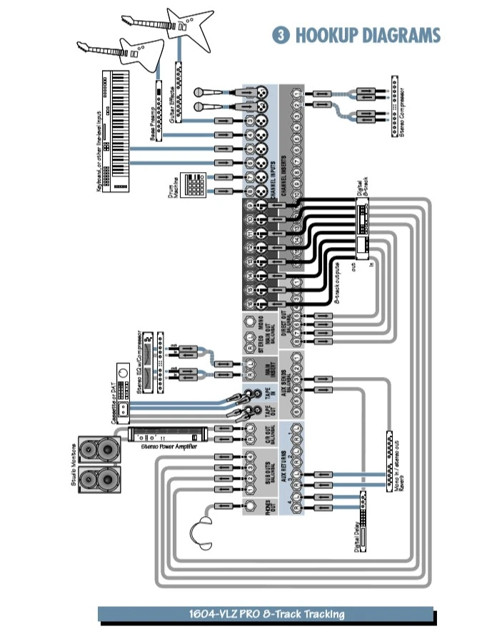

Hook up method. Look good? DAW taking from Tape out RCA.
Well, your diagram really has a lot going on. It is "eat the elephant in one bite" approach.
I think if you want to incorporate outboard gear into your recording, there are many who do this, they probably have a better way of doing it, but I would do it on a case by case bases. Some tracks get this, some don't. But if you are in Reaper, there are no limits to the number of tracks. Eventually when you get it, your workflow will get much better.
But I think staying in the box for now and only concern yourself with tracking and mixing would be your best bet at this time. Then later determine how to incorporate your analog gear into the process.
