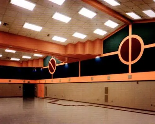

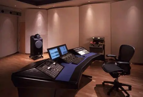

pretty much like the walls they have in this pic.
and for a back wall like this do they just put fabric on the sheet rock?

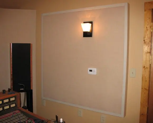

You can do this a couple of different ways..
One is the most $$$, a specifically designed assembly made from vinyl.
Another way is the way I have done it many times; using a 2 by 4 on its edge for the main frame, like a large picture frame, install a material made for screens on a porch, use the same fabric most use Gilford of Maine..
Looks great and is less $$ than option one..
My web site shows rooms that have this method..can have it from floor to ceiling or what ever..
I have used 2 by 6 for thicker panels..

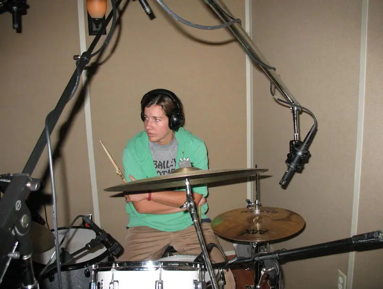

Here's a pic of a few I built.
The drum booth goes from floor to ceiling and is built from 2 by 6, you can NOT tell how thick they are, can't see much from these pics..
They contain your basic 703..

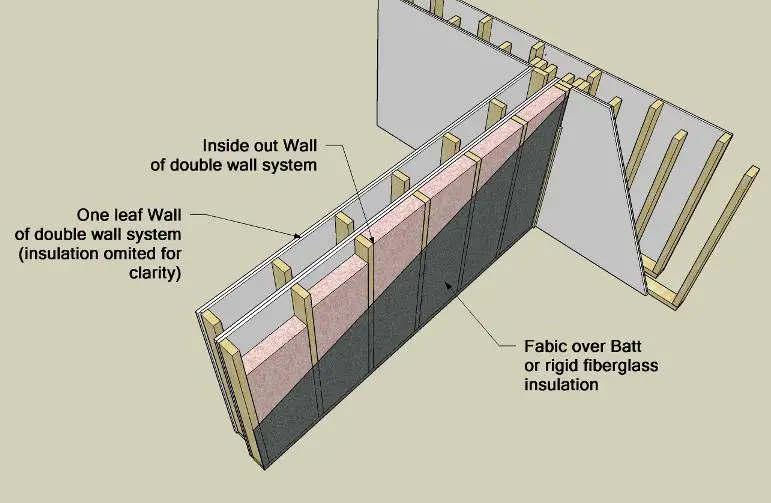

Well, I'm not Mike, but here is an answer. It's called an INSIDE OUT WALL. However, this has to do with how your studio is constructed in the first place. The reason is to keep any TWO LEAF systems intact.
Here's the deal. USUALLY, these type walls are only part of a DOUBLE WALL system, where one of the double walls has ONE leaf of drywall fastened to the room side of the studs, and the Inside Out wall, has the drywall fastened to the airgap side of the studs. This keeps the two leaf system intact while allowing the use of the stud cavitys to be filled with absorption materials, while providing the stud edge for a place to staple fabric. Most Pro studios have EITHER, an Inside out wall somewhere, or enough space to build standard double walls, with fixtures designed to hold absorption material in substantial depths for bass traps, and reflective/diffusive elements as well.
Here is a standard Double wall...
Here is a Double Wall with one leaf built as an "inside out" wall.
The problem with building an inside out wall in a Home studio, is keeping a two leaf system intact. If you are adding a partition wall within a room, then it has to be a double wall with one inside out leaf. If you simply add an inside out wall parallel and adjacent to an existing partition wall, the existing partition wall is most likely already a two leaf system...that is...drywall on both sides of a wood frame. (SEE NEXT POST) To make the inside out wall maintain the two leaf system, you would have to REMOVE the drywall from the existing wall(on the side facing the new inside out wall, and then erect your new inside out wall, which btw, is NOT an easy task,(and dumb in the first place unless you want double walls) as usually, you have to build a precision wall on the floor, sheath it with drywall, and then lift it into place, as it is almost impossible to drywall it while IN PLACE. That's the problem with doing this in rooms that already have exisiting two leaf system assemblies .

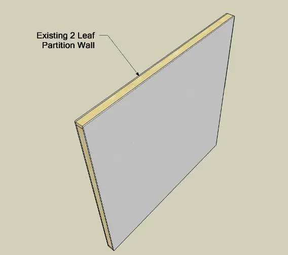

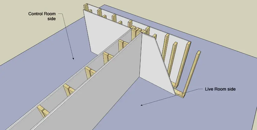

Btw, here's what I mean about building a typical wall frame OVER an existing two leaf partition wall. It does the same thing as a double wall, except that the two leafs are NOT decoupled from each other. This simply allows the existing two leaf system to be utilized, although most people contemplating doing this will ADD another layer of drywall to each side of the system to improve the Transmission loss, prior to adding a frame...which for all intents and purposes, is STILL just a frame..albeit the size of a wall. But a frame none the less.
Here's a standard two leaf partition wall.
Here it is with a framwork for holding the insulation in place.(fabric not shown)
:cursing::cursing: I HATE THIS DAMN ATTACHMENT THING. It totally deleted the first pic. It was supposed to show the Wall by itself. The second one is what came up. It shows the frame attached to the existing wall.:facepalm:
