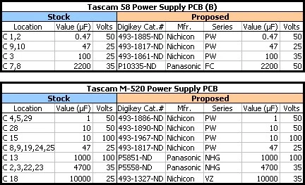

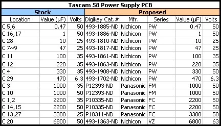

Sorry Ethan and dementedchord...no disrespect meant to you. Your input has been priceless, I'm just pining for additional input from you two or hopefully others as well to specifically address my post a few back with the Excel charts of PS caps...below is another version of the charts with additional specifics as far as the make, series and value/voltage specs of the caps I'm thinking of getting for the two supplies in the 58 and the supply for the 520 (to save the hassle of anybody having to go to the Digikey site and cross-reference to help me out).
Maybe a normal person would just go for it at this point, but this is my very first foray into recapping and I want to get a firm handle on what I'm doing, so if anybody has a few minutes to look at the cap charts below and cross reference with the schematics (M-520 PSU schemo is included in this zip bundle, and a JPEG of the 58 PSU can be found herehttps://www.torridheatstudios.com/f...ascam 58/Tascam 58 Power Supply Schematic.jpg).
I may be over the top on my need for security in this, but that's just me I guess. :o If you haven't figured that about me yet, its never too late! :D
I'm looking for (after a closer look at the materials linked/attached to this post) either "looks good" or criticism/questioning of my selection(s) and hopefully suggestions.
Also still wondering about that 5% cap spec'ed for C12 on the M-520 input card (i.e. Tascam spec'ed a 5% electrolytic but I can't hardly find 10% electrolytic caps much less 5%...:eek:) Do I just go ahead/is it okay to use a poly cap when electrolytic is specified? :confused:
Thanks in advance guys...I think once I get past this first recap process I feel a bit more confident about selections...this is just uncharted territory for me.

as to C12... we've got things spread out in several threads and didnt find the schemo quickly... but did see where ethan said it was a coupling cap to the fader i believe... the reason they might spec a tighter tolerance here is these caps can have a significant effect on the frq response of the circuit... so tighter tolerence means channels will match better... in fact this is one point where i might have suggested useing a larger value... often the bottom end opens up some... polys dont come in large enough values for the most part to sub here... you could always buy 2-3X's as many as you need and test them yourself???
demented, good food for thought...it generates more questions in my mind though from which I will presently refrain...I still don't know where to find electrolytic 5% caps so until I can resolve that its a moot point.
Can anybody comment on my cap selections in my last post?
