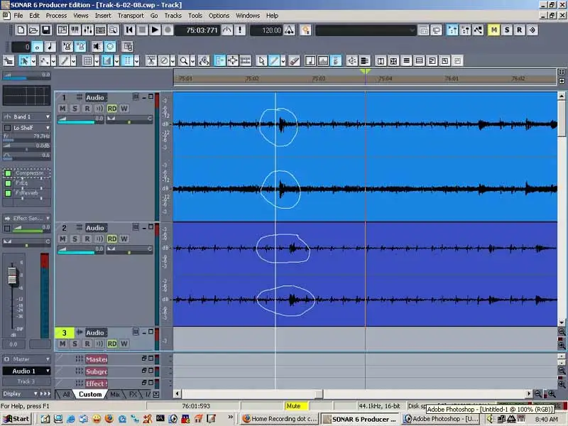

I recorded a drum track in sonar 6 and on a reel to reel at the same time. I then recorded the reel to reel track in sonar. I can get the tracks lined up perfectly at the beginning but as the reel to reel track plays it goes out of sync. It appears slightly behind the digitaly recorded track. How do I get them to sycn up correctly?

I now have the digital track on #1 and the analog on #2 zoomed in so I can see the wave profile very well, especially the stick clicks counting in the beginning. The "Count In" lines up perfectly like below:

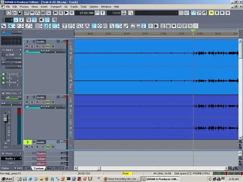

But as the song progresses the analog track falls behind there by going "out of sync". This is my problem:
The pictures I have attached show the start and what it looks like at +50 seconds into the song.

Looking at your waveforms - you say that's just drums? :confused:

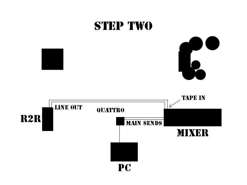

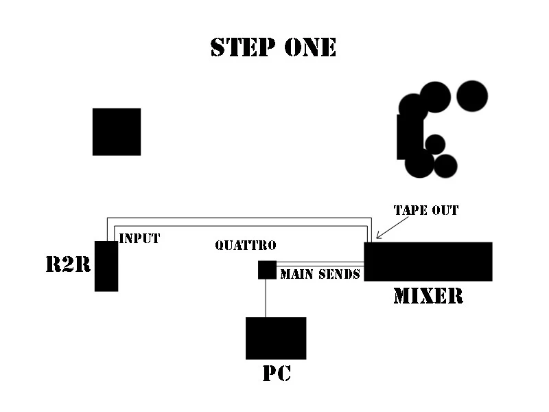

This is what I did. I recorded the PC track first. Then I transfered the recording from the R2R to the PC. the pictures below show the setup and steps.
