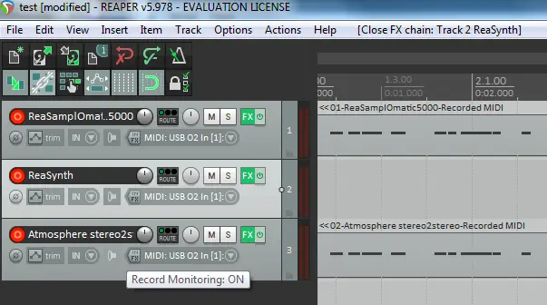

Hmm, I'm not hearing any of the noises no matter what instrument I put on the track. Midi info is being recorded, however. And sound comes out when I add a .wav file to a track. No sound on playback of the midi recording, though.

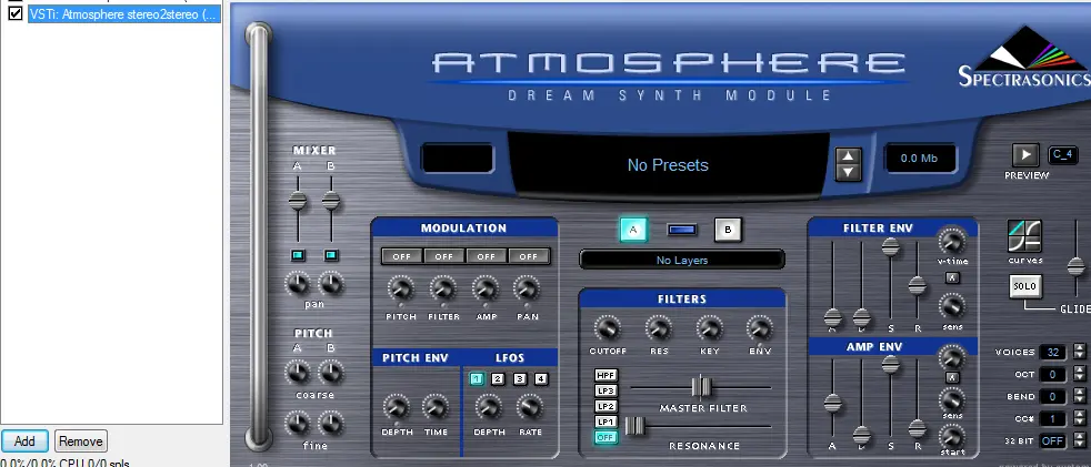

The atmosphere interface comes up and I can add it as an instrument, but it says "no presets" so I can't access any of the patches (which kind of makes it worthless lol).

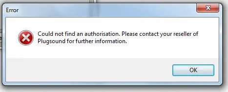

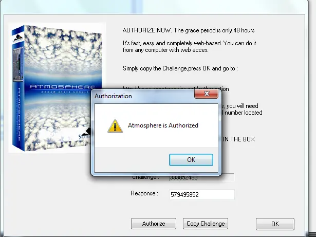

Sure! Thanks for the help! When I click to add the atmosphere vsti to the track it makes me authorize it (every time). It says it is authorized, but when I click okay it gives me an error message. BUT, then it still adds it to my track and I can access the UI. (but there's no presets)

1 You can record a midi signal ok.
2 Reaper knows where to find Atmosphere.
3 Atmosphere has loaded into FX ok.

I can't explain why you get an 'Atmosphere is Authorized' message, then a 'Could not find an authorization' message.
However, one thing to try is to enter the challenge number manually, rather than copy and paste. I read on the web that the copy function is sometimes strange. I don't know if it will do any good.
