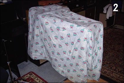

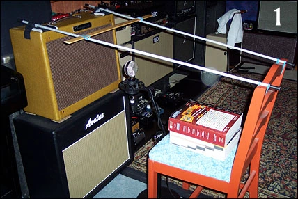

Either build a "tent" with a few heavy quilts/comforters, where you use like a chair and a couple of sticks placed across the top of the chair and amp, and then you cover the mic and amp completely with the quilts/comforters, which will give you maybe another 10-15 dB SPL...or stick the amp and mic in a fairly full decent sized closet, run the cable out, under the door, and close the door and crank it up a bit. That could give you another 20-25 dB SPL.
That way you get more amp volume, but the wife still hears only 85-90 dB SPL.

Here's what I'm talking about when I say make a tent:

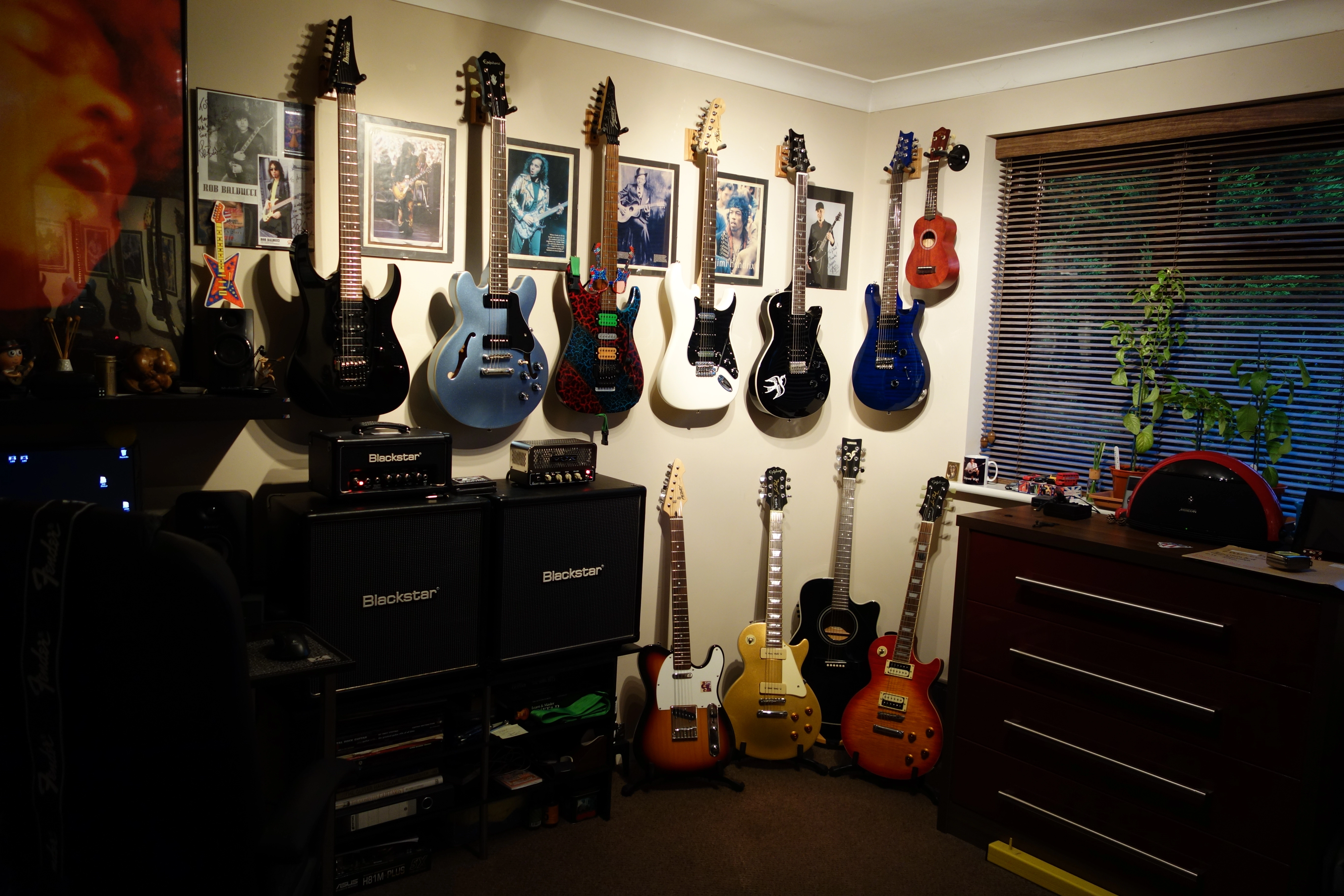

OK, bit more info, I am using a Blackstar 1 watt valve head so it does sound sweet at 85-90db. I don't really want to start moving my room around (see pic below) so I think the preamp option is the best option for me, I just need to know if it will cause too much noise if I go into the GT-001 as that is my soundcard and interface. I also want to know a good brand of preamp for around £100.
Thanks for your help :)
