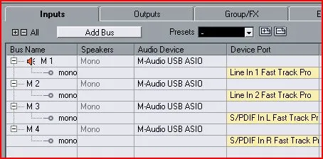

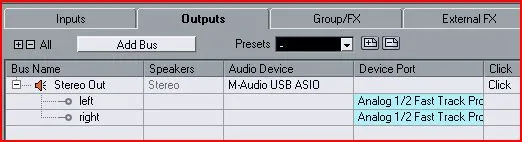

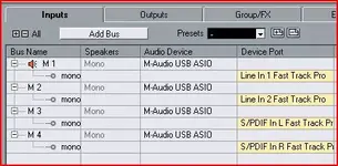

I have done lots of forum research of this topic and I can not seem to find an alleviation. Cubase analog outputs 1/2 (going to a stereo) are fine. I hear things perfect and can monitor with the headphone jack.
Problem:

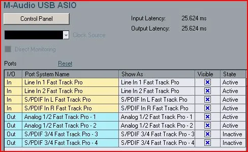

I want to record and although the audio track is recording (visually) and sound is playing, the new recorded track receives nothing. Naturally I have been looking up input issues as my only options for inputs are line 1/2 and SPDIF 1/2 (neither of which work) ...Now I have scoured m-audio forums as well as others and the guide from m-audio regarding cubase shows multiple analog mono outputs. I see none of these.
Any help would be greatly appreciated as I really need to make some tunes.
I have reinstalled drivers countless times and have used Vista 64 bit and vista 64 bit SP1. Computer sound devices are disabled.
Thanks I really am dying to get some help on this.
attached are pictures of what I'n looking at in Cubases VST Connections......And devices

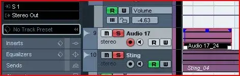

how is the track set up? I assume it is armed to record?
It's going to be a silly overlooked setting in the Cubase track you're recording to. If record enable is selected, check that the monitor 'button' is pushed. You'll get it. It's not a device problem; it's on the track bus. Divide and conquer.

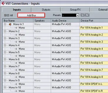

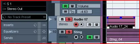

I knew this site was the place to be! I have recorded in ableton lite....I have done a million combinations of arming and monitoring...I assumed the correct one was click track to record to. Click record on track. Click monitor. Click MAIN record. These have not worked. M audio's website shows this for Cubase (refer to pic 1 VST conn FTP Cubase).
Very Frustrating so i really appreciate the help.

The Mute button is on!!!
Also , Audio 17 is a stereo track, but you have a mono source going to it. I'm sure that's not what you want, it should be a Mono track.
Also, the Input says M1, but I don't see M1 listed among your inputs on the Connections page. Maybe that part of the iimage was truncated??

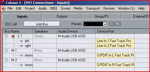

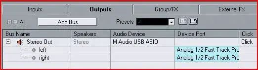

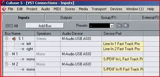

Of course Chili but I do solo it when trying to play it back... Here is an updated picture for you that still cannot be heard. M1 is a result of clicking presets in Cubase as it sets things up for you (like 2 Monos and a Stereo) thus the m1 m2 and s1. I mean I have tried all sorts of combinations. Does it have anything to do with my REALTEK cable mics you think...It can't because ableton records. This has been such a trek.
I tried the same combo and it works for me. I'm stumped also. What do you mean by Realtek cable mics???
There's gotta be something obscure that you're missing. And you had it working for a while.... What could have changed??

Shouldn't you have either the "Line In 1&2" active or the SPDIF but not both?
First diagram.

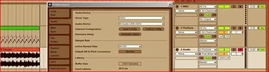

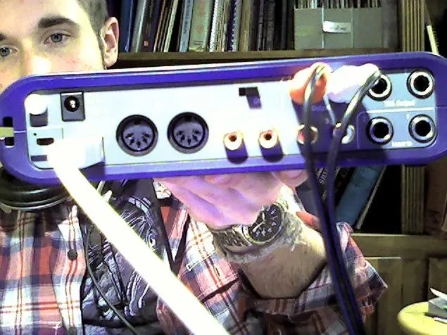

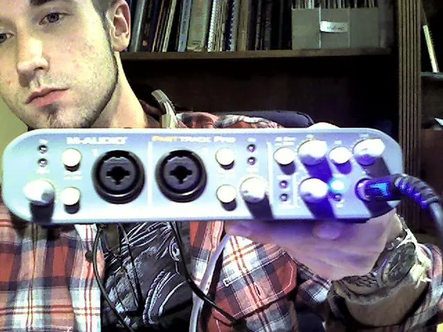

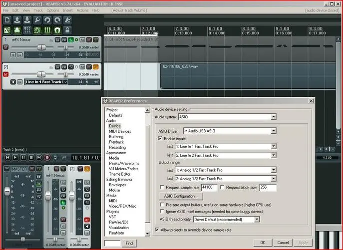

I just downloaded the free DAW "REAPER"...I had no recording on there...So this made me go "maybe my ableton recording was a fluke...maybe i just recorded MIDI...But I just disproved this theory. Here is my latest findings and I am posting pics of the fast track just to make sure im not reallllllll dumb at hooking things up.
Thanks for all the help guys I am going to get this done if it is the end of me.

Plug a headset in to your Fast Track Pro and play around with the balance.
After you shave.
Kidding.
Make sure your ASIO configuration matches your DAW. Same goes with your buffers (256 is what you're showing)
Do you have more than one M-Audio driver?
Do this.
Switch off the Fast Track Pro.
Uninstall your driver.
Reboot.
Go to M-Audio Driver Updates and get the latest version.
Do not turn on the Fast Track Pro until the driver is fully installed.
If that doesn't work, uninstal then reinstall your DAW.
For some unknown reason, everything will be working.

Yeah, after posting the pics, I'm REALLY confused.... you have nothing plugged into the Fast Track except your monitors and the USB plug. Is this how you had it when you were trying to record??
I noticed that too.
He's got "Line In", "SPDIF In" but nothing "Plugged In".
I'm assuming he unplugged things for the photo but he shouldn't need anything on the inputs for monitoring.
