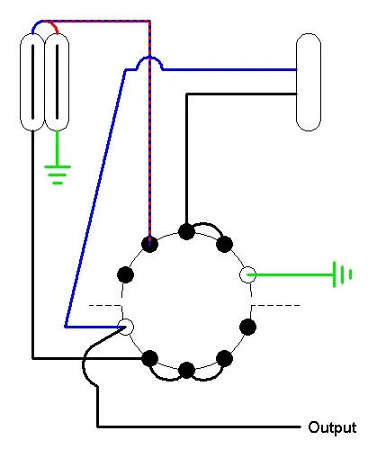

I just picked up a Squire Telecaster which I am considering modifying a little. I'm thinking about replacing the bridge pup with a Hotrail, then changing the switch to a 5 way and wiring the coils of the Hotrail like 2 seperate pups. This way I can have single or double coils on the bridge without adding another hole for a coiltap switch. I'm just wondering if anyone else has done something like this and how well it worked?

Or, you could get a 4-way switch (which is common enough on a Tele), and have the possitions be the humbucker in the bridge, the bridge pickup tapped (i.e., single coil), both pickups, and just the neck pickup. It wouldn't be too hard to make that work. You use one pole on the switch for the output of the bridge pickup, you tie the neck pickup hot directly to the volume pot, and then use the other pole of the switch to ground either the tap or to ground the neck pickup (if the neck pickup isn't grounded, it doesn't matter if you have the hot going to the volume pot, but in possitions 3&4 - where you want that pickup on - you ground it and you've got sound). The only problem I have with that system is you can't have the bridge pickup tapped in the "both pickup" possition - at least not from the switch. You could always do a tone pot tap if you needed that, though (as long as the volume control is turned down even just a hair, the pickup works normally, but if you have the tone control all the way up it taps the pickup).

Thanks for the input guys. The more I think about it the more I am leaning towards a 4 way switch (thanks Light, good idea), anyway I love the crispness of the single coil pups but occasionally I'd like to be able to get the extra growl from a humbucker without having to switch guitars. I guess I really want to get the maximum variety from a single guitar. For what it's worth, the Squire Tele was made in Indonesia and except for the switch seems to be a pretty decent guitar for what i gave for it ($150 new) so I guess the cost of a Hotrail and a switch should be an acceptable added expense and give me a pretty decent guitar (I hope.) I don't plan to retire any of my other guitars but I do like the way the Squire Tele plays.
Here's how I'd wire it (I've got a day off, and I do enjoy wiring challenges!) The blue lines are for the white wires, which don't show up so well on a white background!
Just wire the output into the (preferably upgraded, knowing the Squire electronics) volume and tone controls, and then to the (also upgraded) output jack.
