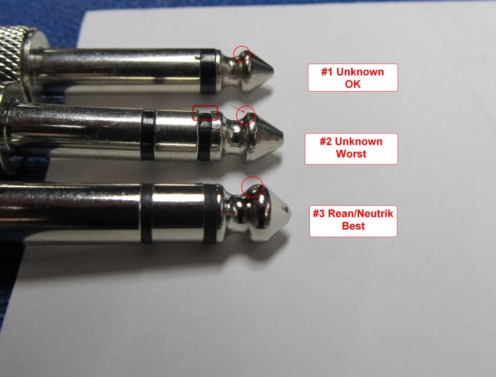

Right to it... I don't like plugging and unplugging from the Zoom because the connections are so tight I'm afraid a cord will come apart at the end and be stuck in the Zoom. Crazy design there! I just use a decent 8 channel mono 1/4" 6 foot snake and leave it hooked up. I know I need a better setup but hey? This has got me into the "box" for good so it works for me.
I found this with my R24 and it seemed some plugs were worse than others, so I took a close look at the ones that had problems. In the image below take note of the backside edge of the tip. The more rounded ones remove easier from the R24. The #2 plug I think were some I got from eBay and they are OK in most gear I've got, but doesn't like the Zoom jacks for whatever reason. I had seen some threads in a Zoom forum that the tip of a plug had actually come of in the jack. The jacks do seem to loosen up with some use.
