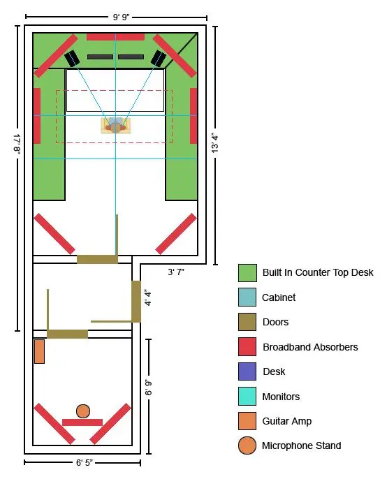

I am now exploring the idea of expanding into our current office which gives me TONS more space.
In the diagram below you can see the dimensions with my current recording space at the bottom. I track and mix and do everything in the small 6.5' x 6.5' closet. You will also see the layout of the office space.
If I end up moving forward with the expansion, I want to get some ideas on how I should set up, where I should track, listen, etc.
First here is something to keep in mind:
** The built in counter top desk must stay in place and can not be moved or taken down. Preferrably the cabinet stays put as well since its mounted to the wall but I could move it if it is necessary. **
My initial ideas are this:
1) Keep my desk in the closet where i can keep my computer which will record all the tracks into it. Also leave the monitors so that I can have a small little listening room which is already treated with absorbers.
2) Keep my mic stand in there also since its a smaller room and I still have room to sing still and easily access the computer to stop and record when necessary.
3) Move the amp out into the office space and set up a live area for electric, acoutsic and bass guitar tracking. This will give me MUCH more elbow room when playing guitar which I lacked in the closet.
4) The office area's cabinet is a nice place to store all of my cables, cords, headphones and any other things I need to store and keep out of the way.
(I thought at first about keeping the closet for just a vocal booth and bringing the desk and computer out into the live area, but with the built in desk it is kind of akward to set up the desk, having the monitors and myself at an equilatteral triangle and STILL have space for the guitar tracking areas...but of course this is why I am asking for advice since I am a noob and trying to get a nice set up going)
Initial concerns / questions:
1) If I follow what I said above and move the guitars out into the office area, how do you go back and forth from playing guitar to the computer in the closet to stop, record, etc...? What is the best way to achieve this?
2) Will I need some more absorbers and/or bass traps in the live area or can I just build a few absorption panels that I can put in a semi circle around my amp when recording?
3) Whst the best use of the bigger office space?
Ok, I am sure there will be many many more questions as some people start chiming in with soem setup advice, so I will just leave it at this for now.
Thanks in advance!!

Can you snap some pictures of the cabinent and counter?
I added an extra wall.. Just wanted to see how it would look that way.. Probably not practical, at this point..but adding it would mean better isolation to the rest of the house and vocal/amp booth.. I staggered the doorway for more isolation, but mainly for more a more symmetrical mixing room...
Any thoughts?
You could always build the wall I added and remove the current closet doorway wall... Recycle the door and hopefully studs... That would make for a pretty cool live room or mixing room.....

Ok a few things:
1) Really didn't want to tackle the heavy construction (IE building walls and tearing walls down..), was hoping for a simpler set up. But I must say that's a cool idea that I never thought of and I may look into it further hehe :D
2) Even if I explored the construction route, and had it set up like your latest diagram, why would it be better to monitor in the one space and track in the other? I mean, its better to monitor in a larger room or something?
3) I had the monitors on the desk shelves because of the small closet space. If I did your diagram, wouldnt it be better if they were further back against the wall on shelves or something and not a few feet from me?
4) what program do you use to mess with my diagram? I see a lot of people doing diagrams that have similar looks/styles to them but I always just use photoshop and it takes mne forever lol
Again, thank you for taking the time out and any other ideas or suggestions are much appreciated.

Is the extra countertop install necessary? It was a pain hehe. I like your placement of absorbers however and even the monitor placement. Whats the other 2 things on the front counter?
Thanks again

No prob.. It's all good... I enjoy the studio planning thing...
Yeah.. I can undertand that.. I'm unable to do any major changes in my studio too..
I would be concerned about early reflections and room for good bass traps, in the small room.. Otherwise, I'm sure there are reasons on both sides of the coin.. I get scared of running outta space for gear.. hehe.. Plus, if someday you got a big mixing board.. You'd be ready...(which appears to be that black rectangle in Panda's version)...
Yes, prolly so (further back).. I think we touched on this back at 1.0... I was wondering how high the desk counter was... I wouldn't do shelves though.. Unless you had too... (good stands will give you better sounding speakers, so the story goes..)... You question leads me into my next proposition..
First off.. Panda's version is the best of the bunch, in my opinion...
Only two things I see that I would change are....
1.That counter in the top portion of the room might be useless.. You might be better off just having identical counters on your left and right... Two good speaker stands and some simple platform for the lcd screens (the screens should be further from you than the centerline of each speacker)..
Depending on how the counters are constructed, you might be inviting move problems than good, by moving out into that room., as is.....
2. The "immediate reflection zone" isn't covered... (On my original pix, its the topmost horizontal blue line)... It is the point of equidistance betwen you the speakers' "line".. Notice how, on my pics, the aborbers are directly centered on that line..

Having the speakers really close to the wall would be bad... You might look in the manual of your monitors to be sure.. If it doesn't say.. I'd go about a foot or a foot and a half from the wall... Sounds reasonable to me...
The reflections you may be right on and as far as the big mixer I dont see it happeneing since I am not recording bands, just me myself and I :) but I guess planning ahead in case I ever decide to do more isnt a bad thing, just not in my immediate plans (within next few years).
The top counter may be useless (all of the counter may be useless, but I cant remove it, and really dont want to add a left side either if I can help it).
Yea speaker stands sound better if my final layout allows me to have them.
yea, thats what I am thinking, but geesh way more space and seems like I could/should take advantage of it somehow...
