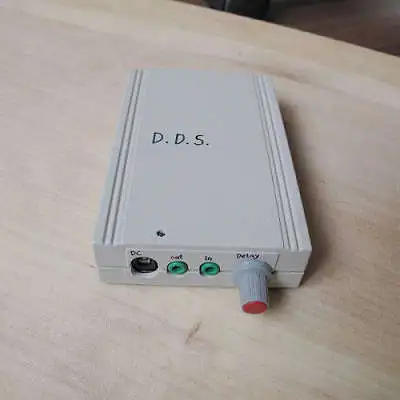

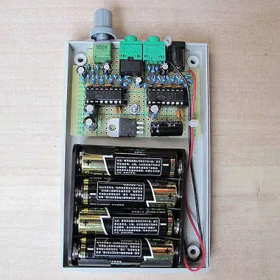

D designer.zang New member Dec 17, 2009 #1 hi all,this is my first post i want to share something useful i built the unit with breadboards,pt2399 delay chips,standard resistors,sockets. it work for real time play keyboard or recording. -digi01 Attachments digi01_dds_02.webp 23.5 KB · Views: 380 digi01_dds_04.webp 5.5 KB · Views: 279

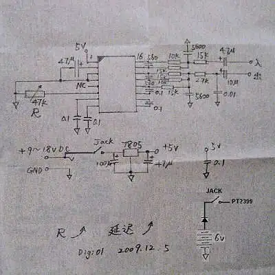

D designer.zang New member Dec 18, 2009 #3 it is a nice delay.i play keyboard via this unit. the below is a craft schemcs,it only show one channel. -digi01 Attachments digi01_dds_05.webp 20.3 KB · Views: 257
