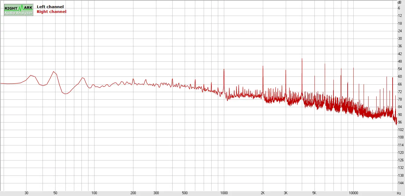

Highpitched whining noise; how to get rid of it?

Battery or plugged in makes now difference and I only get it with mics, recording line in is no problem; I tried out a lot already.
The recording is with the mics pointing in the corner where the noise is worst and the gain fully open.
In practice it's more like a faint background noise and sometimes it isn't there at all.
I do live in a typical Amsterdam situation with neighbours left right and under me who all probably have wifi and whatnot.

It does have some of the hallmark of USB noise? The 1kHz spike and then more spikes at exact intervals.
I am more concerned about the underlying crackle? This smacks to me of a poor earth/screen connection in a mic cable but if you have tried various mics then I dare say you have tried more than one cable? If not a cable then perhaps a bad joint inside the AI.
