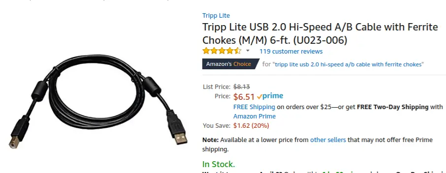

So with that I wonder, if ferrite chokes on the USB cable could help?
My interface USB has those chokes on both ends.
and dont forget to turn off the smart phones when around the gear, mine makes noise around my system.

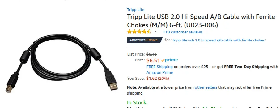

Thanks! That USB-cable seems like a good thing to try first.
I tried turning of the phones (even disconnectiong my Wifi) but that didn't affect it at all.
I just type google on a high pitched noise...and another audio forum" one dude mentioned it fixed his, while another posted it wont work.
Its cheap enough to try a cable.

I was looking online for that USB 2.0 A/B Cable with Ferrite Chokes but I haven't found any others that I can buy in the Netherlands. I'll shop around some more though. Thanks for the suggestions. I also contacted Focusrite to check what they would recommend.
the cables often come with printers too, if I recall. maybe someone has one and doesnt even notice it has the chokes.

The 2i2 I mentioned caused so much grief we returned it and my colleague got a Roland instead, which is silent. I have another interface I use with a portable system, and it too has this problem when used with the laptop I wished to use - moving to a different one solved the problem. I tried all kinds of ready made, and home-made chokes, and they didn't cure the problem. That characteristic buzz is a real pain - and so randomly produced.
