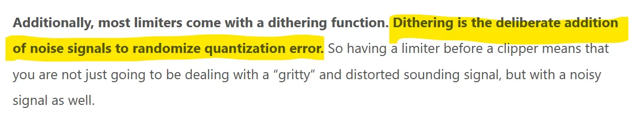

Isnt this where dithering can help? When there are random synchronization errors (in m/s) between the fresh tracks from the floating point recording process. You dither the render. This fills in and evens the timing of said tracks. Fixing inherent latency issues and such. You dont need to dither twice. Once does the trick.
MP3 has nothing to do with dithering. Dithering is randomizing the least significant bit of an audio sample. It doesn't affect timing or latency in any way. MP3 encoding uses psychoacoustic modeling to analyze a signal and decide that it can throw out certain parts of the sound because it is masked by other parts. That's why it's called "lossy". Once you throw the information away it can never be retrieved. Part of what using lower bit rates do is to toss out higher frequencies. Look at 128K MP3 response and you'll find it's roughly equal to an FM modulated signal with a cutoff of 15kHz. 64Kbps tops out at around 11kHz.
It's like the difference between a JPG file and a bitmap file. If you repeatedly save a bitmap file, it will still be the same. If you re-encode a JPG, each generation will lose more detail. The same thing will happen if you decode and encode an MP3 sound file repeatedly.
Quantization error is where you have to decide between 2 numbers which are not exactly the true analog value. The way to make this less apparent is to randomize the lowest digit so that you don't get consistent errors which would creats a specific type of harmonic distortion. Essentially you are adding noise to the signal, although if you are working with a 16 bit system, the noise is at -96dB. With 24bit, it's at -144dB below the max level. That has the effect of lowering the overall distortion.
It still has little if anything to do with MP3 encoding, latency, syncronization or timing. MP3 encoding might use dither to try to lower the distortion, but it's still throwing away lots of data.
