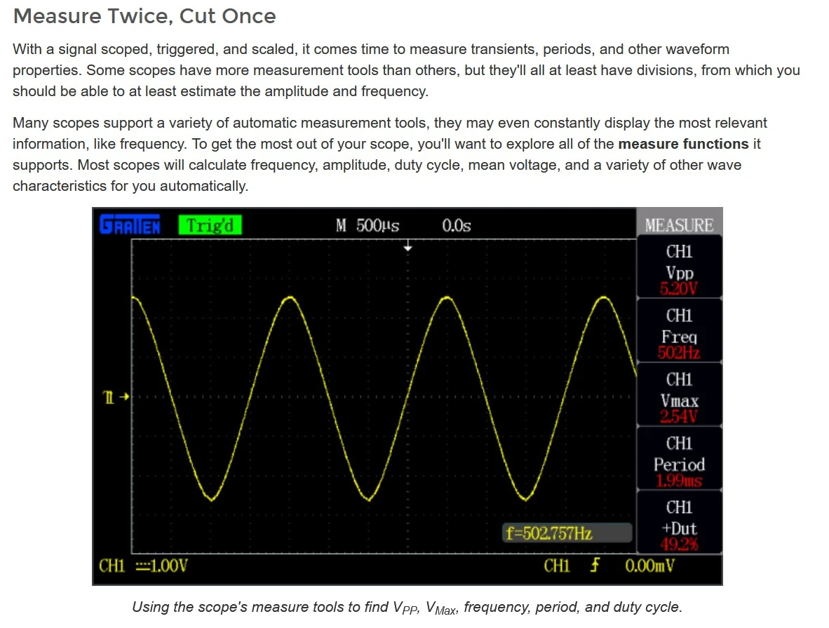

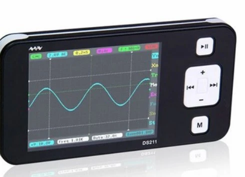

A visual device that can be used to measure waveforms.
People I played with , we used them during recording, tuning, or just to look at the pretty wave from the synthesizer on the screen. they help to find and isolate noises.

do they go down below 20hz, please, do they use a microphone?
Yes you can input a mic, of coarse.
They go to zero , man
I rebuilt transmissions, not good with computer stuff . Cel phones today could have O scope apps. There might be software options. This will prove if there is something there or not regardless if they say they can 'hear' it.
